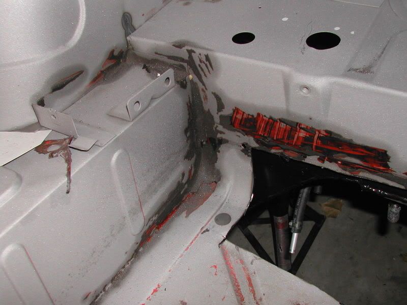

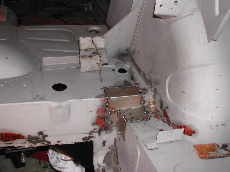

A couple pics of the fun I am having. The top one is where I cut the ripped section of metal out of the trunk and fabricated a patch panel (The car was hit in the rear at some point before I purchased it). This little flaw was a nice little surprise after getting it blasted. I am finally getting quicker at this process but anywhere I can work smarter I am up for it.
In the lower picture you can see the seam sealer, I was just wondering what removal methods you have found the most effective? A razor scraper and wire wheel work OK but can't get everywhere. Does paint stripper work? I would prefer to see what has been done in the past before making a big mess.
Thanks

A lot of that old seam sealer was asphalt based, so paint or lacquer thinner and a scraper will work. For the other hard stuff, I used paint stripper and cleaned the seams with soap and water, blew it out.
Thanks for all the info. Looks like I will scrape as much as possible and use paint thinner to clean up the rest (much happier to use that stuff than paint remover).

A cone shaped stiff wire brush mounted on a electric angle grinder works wonderful. A good tip before you re-seamseal is to spray an epoxy base primer first then seal over top of that. Seam sealing over top a etching primer may cause some compatibility issues. Many sealers will crack in time over etching primers.
