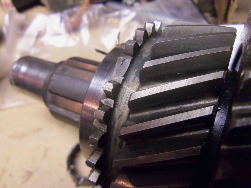

Going to start to compile a list tonight to place an order for transmission rebuild parts. I've read there are different quality parts out there like synchros. What about bearings and etc. I'm going to need all synchros, bearings, counter and reverse shafts, all gear bushings and possibly 3rd gear. Take a look at the pic which has 1 chipped off synchro tooth. I'm thinking 1 tooth is no big deal?

One broken tooth might not be so bad, but from what I can see, the points on the other teeth are pretty well ground off as well. That may make it hard to shift into 3rd gear.
