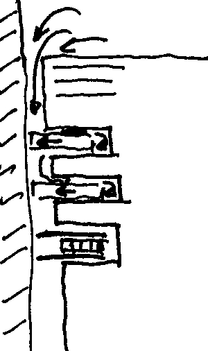

The piston to wall clearance is nothing to care about if set correctly. You don't scrub material off the piston while beak-in you just flat in the surface and rise the density of the alloy ...at high revs that is more effective and give a better resistance to wear. I already talked about the rings.

Mad Marx, I agree with you on the bearings but only partially on the piston/cylinder. A stock or non race motor with less clearance is going to produce more friction and heat at higher RPMs, untill the piston and rings are seated in as you described above you risk the chance of scuffing/scoring the cylinder and rings and then you would be scrubbing material off. Setting the piston/cylinder clearance will vari according to what kind of motor and what you are doing with it. With my race motors I increased my piston/cylinder clearance aprox. 1-2 thous more than what a typical non race motor would be--with that setting I could run my motor up for 20 min.--reset the valves, go to the track and race. That shouldnt be done (high rpms) with a stock motor because of what I mentioned above.--not trying to be argumentitive--just a friendly disagreement.---------here are two sites with break in pocedures, one is from a respected high performance shop in Utah https://www.rpmrons.com/enginestartup.html and the other is from a registry for an older Porshe https://www.356registry.org/tech/engine-breakin.html
