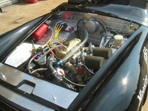

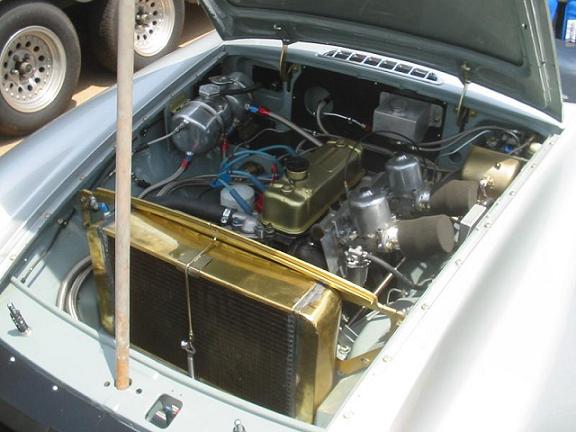

I agree with Jack in saying NEVER-NEVER run a street engine without filtering the intake air. Velocity stacks are for race car engines and some times even that is debatable, depending where the car is running. There is no comparison to the cost of an engine and the cost of a pair of air filters. Put a little sand between your hands and rub them together, imagine one hand being a piston and the other the cylinder wall, mixed with a little bit of oil of course, you know, to help keep the sand in there.
Even on the rae cars where we use the bell shped velocity stack we still use filter, I used uni-filters I sourced from motorcycle shops in the past, even racers filter thier air into the carb, well atleast smart ones do :smile:

Wow, those engine bays look like sterile operating rooms!
Hap Waldrop said:
Even on the rae cars where we use the bell shped velocity stack we still use filter, I used uni-filters I source form motorcylce shop in the past, even racers filter thier air into the carb, well atleast smart ones do :smile:
Geez, Hap - it looks like you only have half enough filters there.....is that the economy version..... :thumbsup:
I guess we better get the air filters on this car ASAP.
