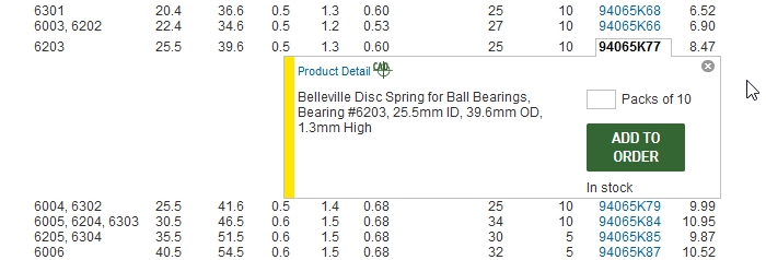

Looks like these are spec'd as follows: OD, ID, thickness, dish and flat load. I think it would be a real SWAG to get those :confusion:

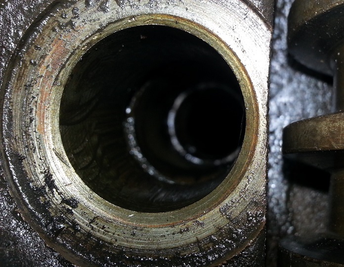

The raised-lid box I have has definite wear marks from the washers. The flat-top box has been thoroughly cleaned and marks from washers are not as obvious. In both cases, the box has a machined flat surface for the washers to rest on. This machining in the flat-top box is rather rough compared to the later box.
Hope this helps!
Pic of marks from washer in raised lid box.
