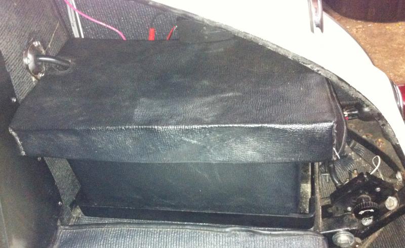

Similarly, the addition of the referenced thin plastic cover over the battery will add some good protection too:
1] Protect your goods thrown in the boot when traveling from contacting battery acid if any leakage.
2] provide additional insulation coverage over the generally exposed battery terminals

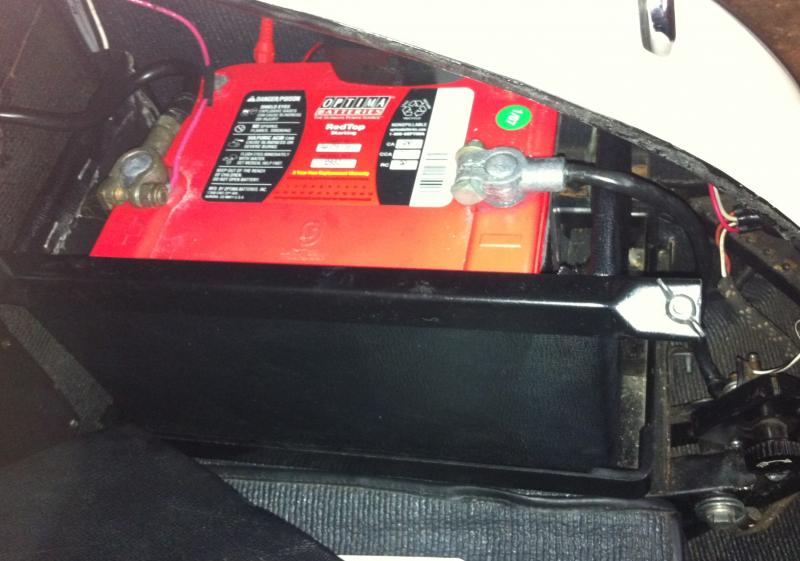

By the way, when did the standard battery hold down change? As original, my Healey came with a bracket that had 2 diagonal end hold-downs connected to an angle that pushed the battery back into a piece of wood anchored to the inner fender. The base is formed by 2 end pieces of angle iron welded to the frame with a piece of wood across the space and containing the hold-down anchors for each of the diagonal rods.
attachment.php
attachment.php
The Optimum battery was placed in a wood box and the box in a battery tray. By the way, the wires appearing at the back of the battery are to provide constant power to my radio and is fused.

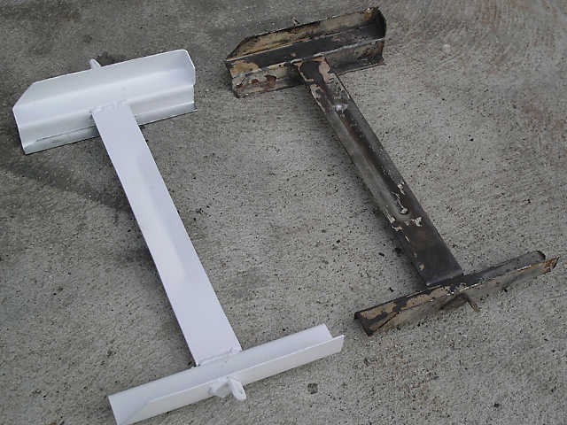

I am not sure what the bolts were hooked to that supposedly held the battery in place.
Hi Brent,
In this photo, you can see the mounting point for the hooked bolt. In the foreground, the small piece welded at a 45deg angle. There is another mounting point at the other end of the bracket. As Keoke said, the tray isn't attached to anything.

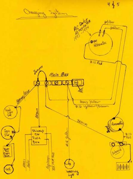

OK, so here's some more things to keep you awake at night. If you're running an alternator you might want to consider protecting the alternator to solenoid connection with a mega fuse, otherwise an internally shorted alternator may cause your car to burn down. And if you run a battery box, make sure the battery is vented so the car doesn't blow up. And then there's that nasty javelin steering column that will pierce your heart in a crash and the lack of antilock brakes, no back up camera, headrests, lane change alarm, etc, etc. Sometimes ignorance is bliss. Just got a recall notice for my ten year old Chrysler 300C SRT8. Apparently I've been driving for a decade with an airbag that's just waiting to leap out of my steering wheel and kill me. Men and ships are not made for safe harbors.
Thank God you wrote that in the morning Rick. I have a lot of hours before bed where I can try to forget all that. Maybe throw a beer or two into the mix.
OK, Men and ships are not made for safe harbors.
HERE, HERE, Rick. Maybe an answer to that Alternator waiting to sabotage us is an Amp Meter. The 30 amp amp meter will act like a fuse and open the circuit before the car burns down. Dave.
