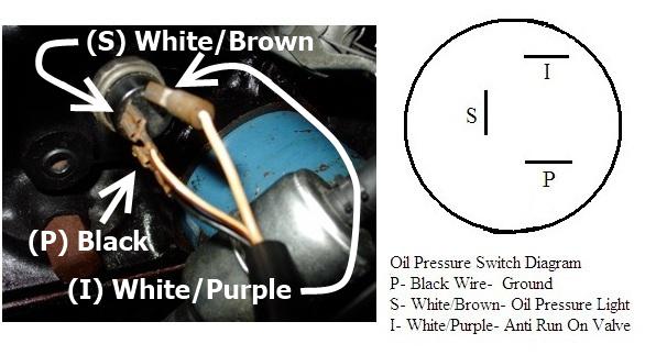

Have a new battery and have a disconnect on the negative post. When the battery is disconnect, the charge holds. When it is connected, there is a charge loss to zero over a few days. Thought it might be one of the leads (direct to the battery) for a new Retro Radio (to keep memory, but the drain is very slight. Disconnected the lead to verify, and the battery still loss charge.
When you connect the battery, there is a loud click in the right front under the carbon canister, which I assume is the anti run on activating. Could this be the problem?
Thanks in advance for your help.
Will
Elliot -
When you disconnected the wires to the ARV, did you plug the canister line to the valve?
Thx,
Will
It’s been a couple of years, but I don’t believe I did.
If you want to check the ARV operation, the ignition key will send power thru the Brown/Red (N/R) wire when the ignition key is in the OFF position...that's normal, but the ground (White/Purple/ W/P) should not be completed unless the Oil Pressure sensor switch detects some residual oil pressure.
If you hear a click from the ARV shortly after you kill the engine, the ARV is working as designed...what you hear is the ARV solenoid closing the path (i.e. valve) at the ARV from hose on the intake manifold's banjo fitting.
If you want to maintain the " basic function" of the carbon canister there needs to be an opening at its bottom for fresh air to enter and do the purging of the carbon layer...so if an ARV is disabled you can either leave the interconnecting hose in place, so the fresh air can pass thru the disabled ARV or you can remove the interconnecting hose so air can directly enter the CC like the pre-73 versions.
Just curious. In my situation, by disconnecting the wires, the valve stays open, and it vents through the bottom of the valve. (Who knows, maybe this will help my hot idle problem).
Still checking the wiring to my new oil switch, but headed toward the disconnect solution.
Thx again.
Will
The wires on the switch:
