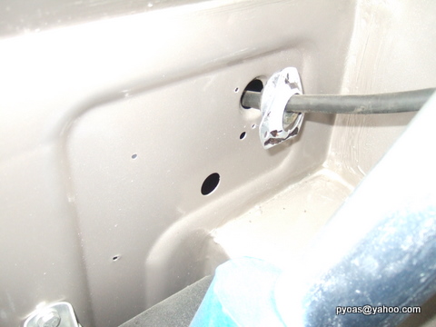

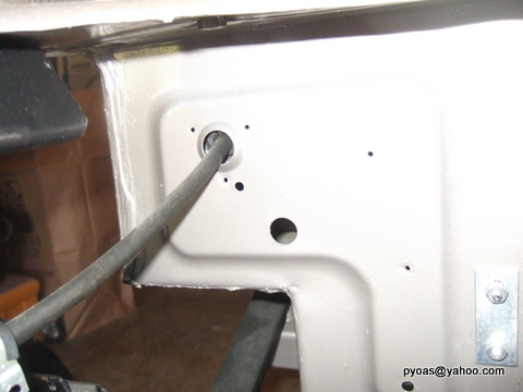

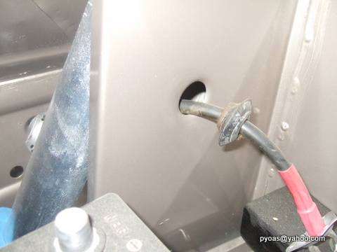

Try these pics.
Patrick

Bob,
As far as I recollect, there is only 1 hole in the filler enclosure wall closest to the battery and one on the bulkhead at the back. The cable passes through both when traveling from the battery to the differential/wheel space. An additional hole, closer to the center of the bulkhead, is for the gas line.
If you have 2 holes on the filler space wall nearest the battery, then I suggest the additional was installed by a previous owner. Again, it is from memory that I am talking and was under the impression the BT7 was similar (if not exactly the same) as my P1.
Ray (64BJ8P1)
