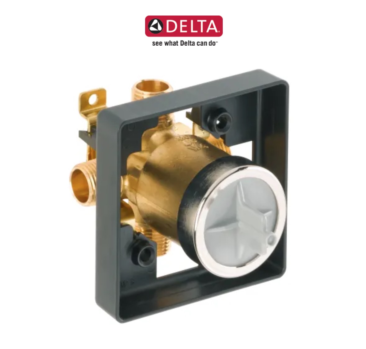

So the new Shower valve I installed is the Delta Universal Mixing Valve, model R10000-UNBX. Even though I'm still working on the bathroom floor (fixing cracks and leveling soon, then tiling) I am still using the shower since it is all finished.
The new shower has been working fine up until yesterday. I had taken a shower and everything was fine, or so it seemed. The shower shut off just as it always has. But then, about 10 minutes later, for no apparent reason, the tub faucet started running full blast. The valve was in the off position and no amount of turning the valve on and back to off would stop the flow. I had no choice but to turn off the water to the house (valve in the garage) and take the Delta shower/tub valve apart to see if I could find any problems. This valve uses a "valve cartridge" that fits into the brass valve housing. Nothing looked out of the ordinary, but I blew air into the two holes at the back of the cartridge just in case something internal was stuck (the cartridge can't be disassembled). I put the cartridge back in and reassembled the valve, after which the valve seemed to be working fine again.
I called Delta and explained the problem and they concluded I probably have a defective cartridge and have sent out a new cartridge at no cost. Obviously (I think) some internal mechanism just got stuck and caused the valve to turn on. Anyway, hopefully the replacement will solve the problem.

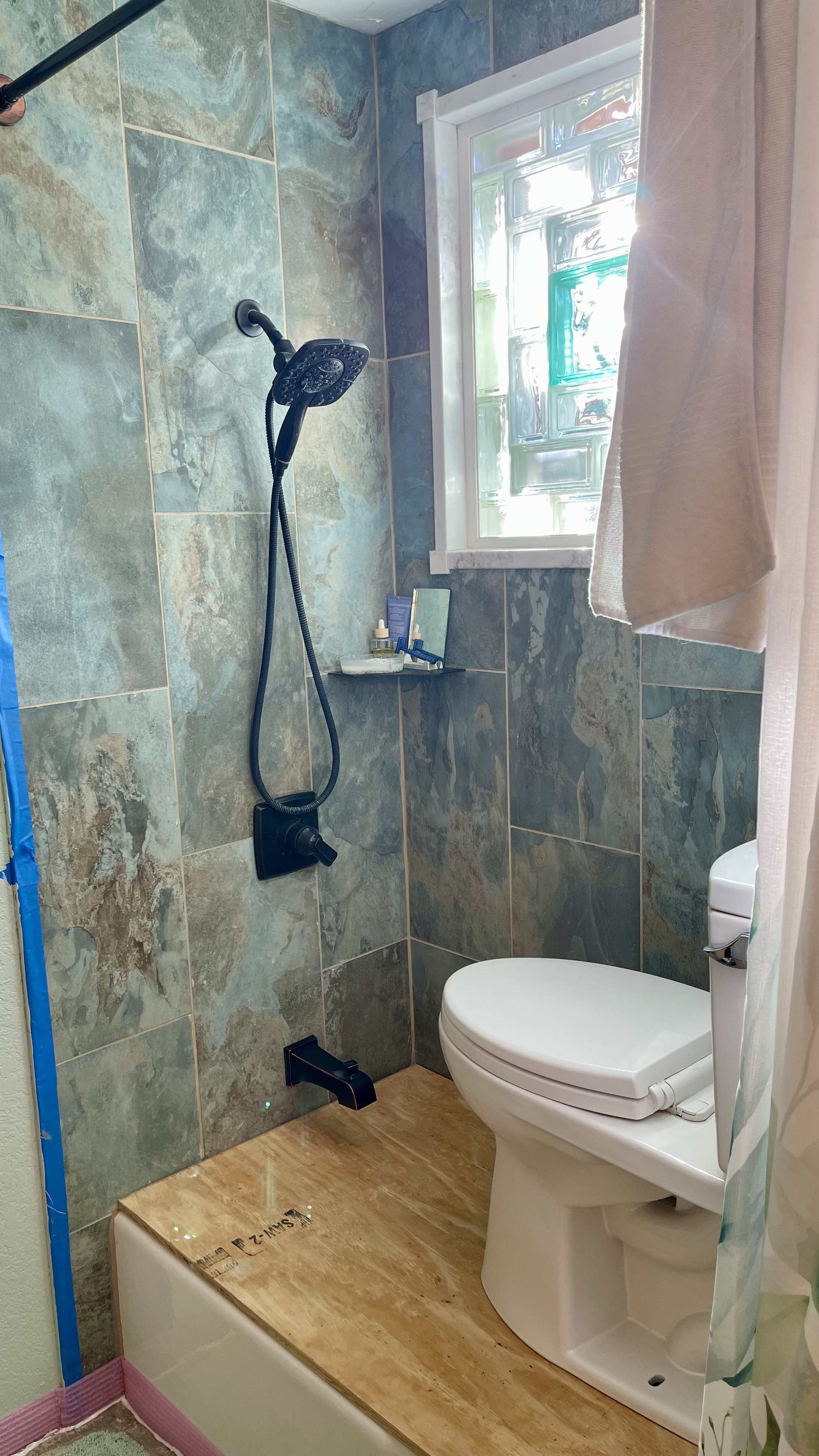

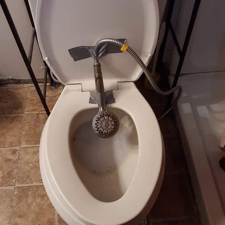

While getting the floor ready for leveling, I needed to get the toilet out of the way. Didn't really have any good place to put it. The garage was a possibility but was kind of full with other stuff. Then I had a flash and invented the "toileshower" in the process! Not only does it get the toilet off the floor, but it allows you to take a shower while you're doing other "business." :flush:
You may laugh but the first time I went on a cruise it was a renovated 1950's steam liner and the bathroom was like your photo! The entire (very small) room was the shower stall and the commode was just in one corner.....still was one of the best showers I ever experienced though....unlimited hot water!!!
Well, now that I think about it, many campers that we rent from the local AF base to go camping have what they call a "wet shower" with a shower and a toilet in the same phone-booth sized space.
That's pretty common in heads (bathroom for landlubbers) on sailboats.

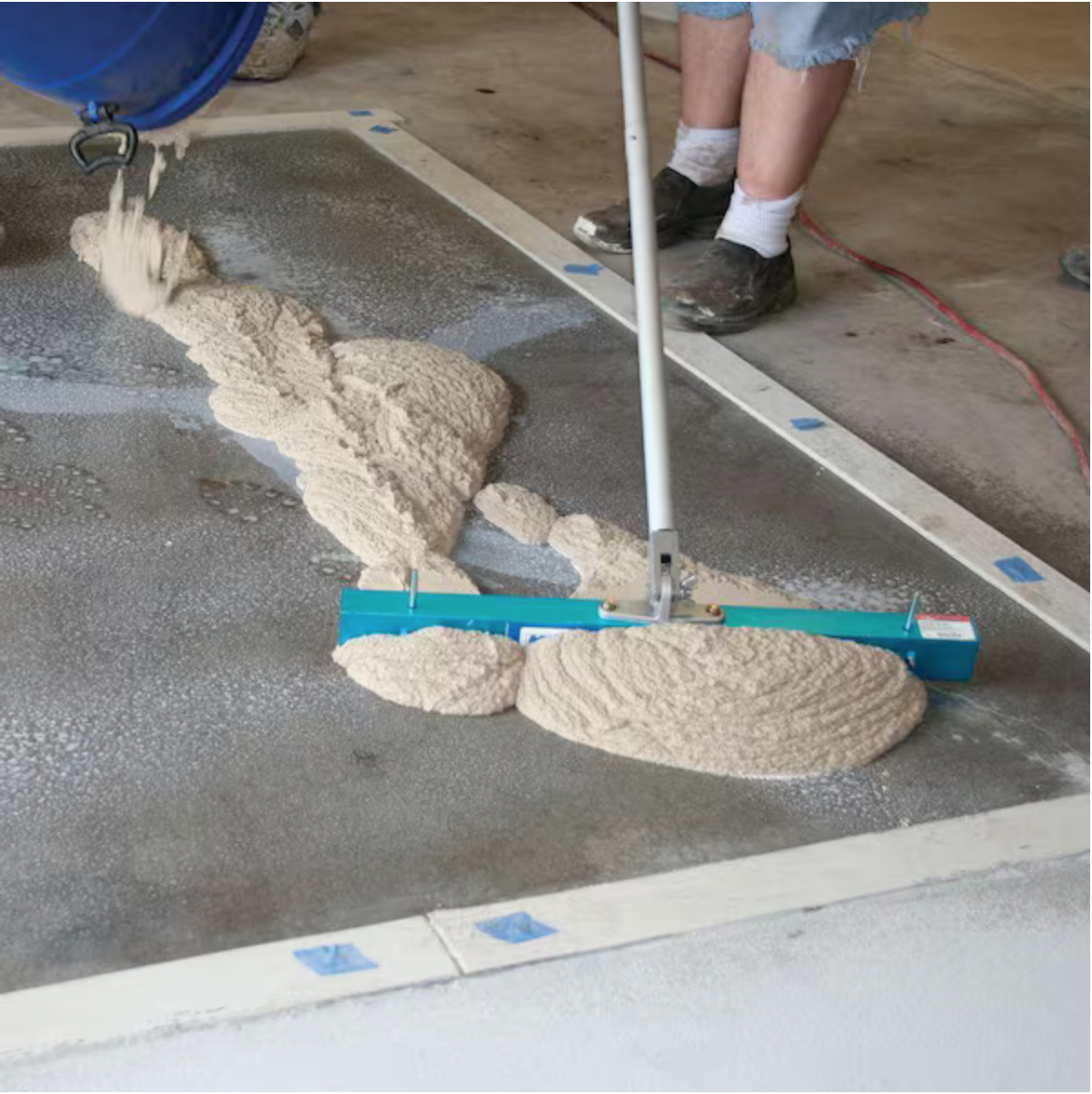

I've been held up due to cold weather. One of the long-pole-in-the-tent items I had to accomplish was to pour Ardex 1400 leveling compound on the floor to level it out. Since I had to mix the stuff out on the back porch, I needed the temperature to be relatively warm. Finally, a couple days ago, we had a day that the temps got up to 66F. I had my son come out to help me mix and pour the leveling compound. I used a special tool called a gauge rake to spread the stuff on the floor at an even depth (1/4"). I was pretty happy with the end result. When it dried and had leveled out, the floor was (is) nearly perfectly level.

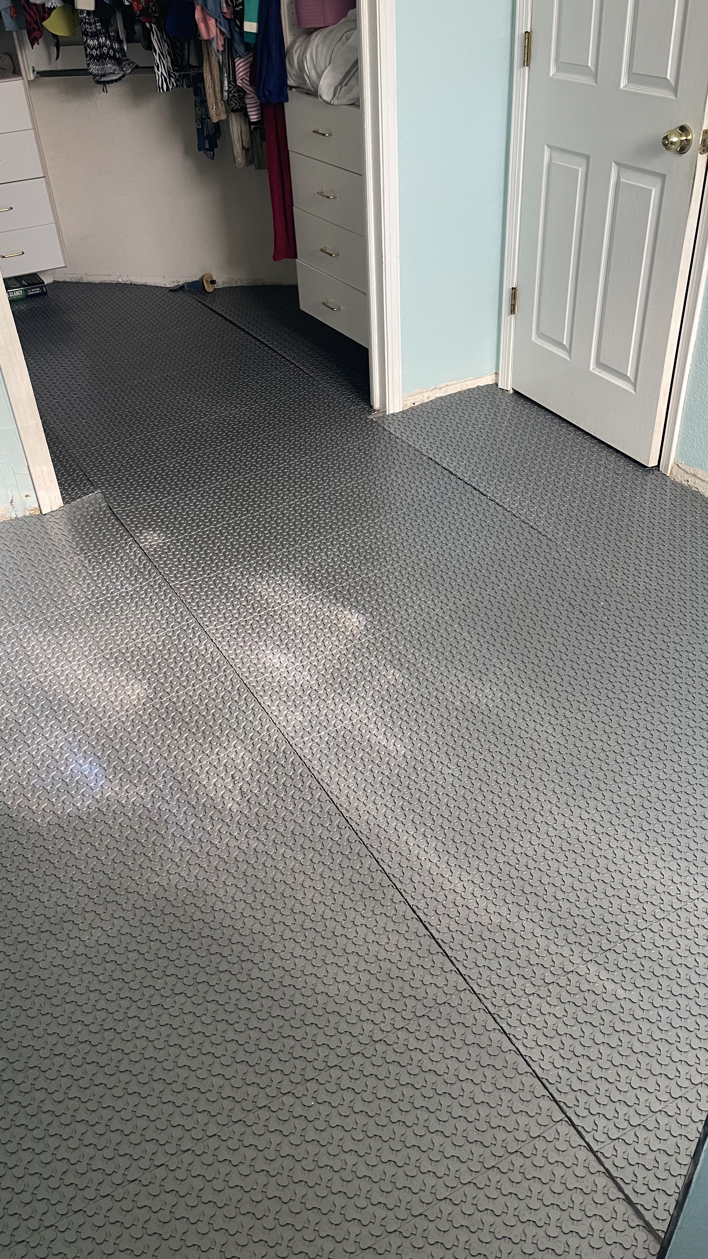

The next step was to cut the Ardex Flexbone decoupling mat and fit in to the floor., which I completed yesterday. The decoupling mat is probably overkill, but in the event the concrete slab were to crack due to changes in temp, shifting foundation, etc., the decoupling mat serves to isolate the slab from the porcelain tiles, thus (in theory) preventing any cracks from transferring to the tiles. Like I said, probably overkill for this job, but I just felt it was good insurance against future issues.
Today I have rented a heavy roller from Home Depot and will be gluing the flexbone to the newly leveled concrete slab using Ardex 77 thinset. I'll be using a 1/16th inch v-notch trowel to adhere the flexbone mat to the slap, then rolling over it with that heavy roller. Hope to get that finished today.

The gauge rake spreads material at a consistent thickness (adjustable).

Flexbone decoupling mat ready to be glued to the newly leveled floor.

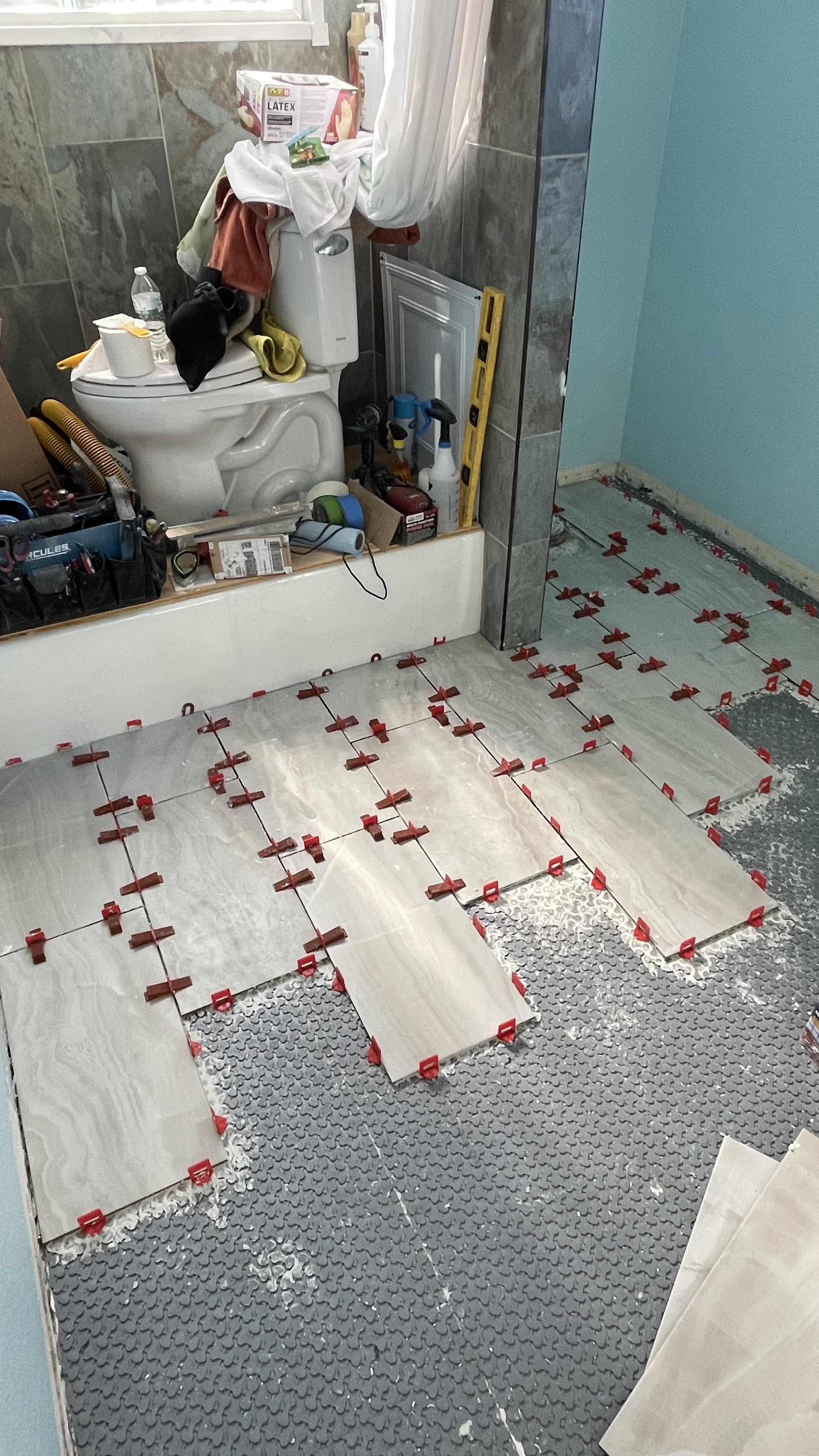

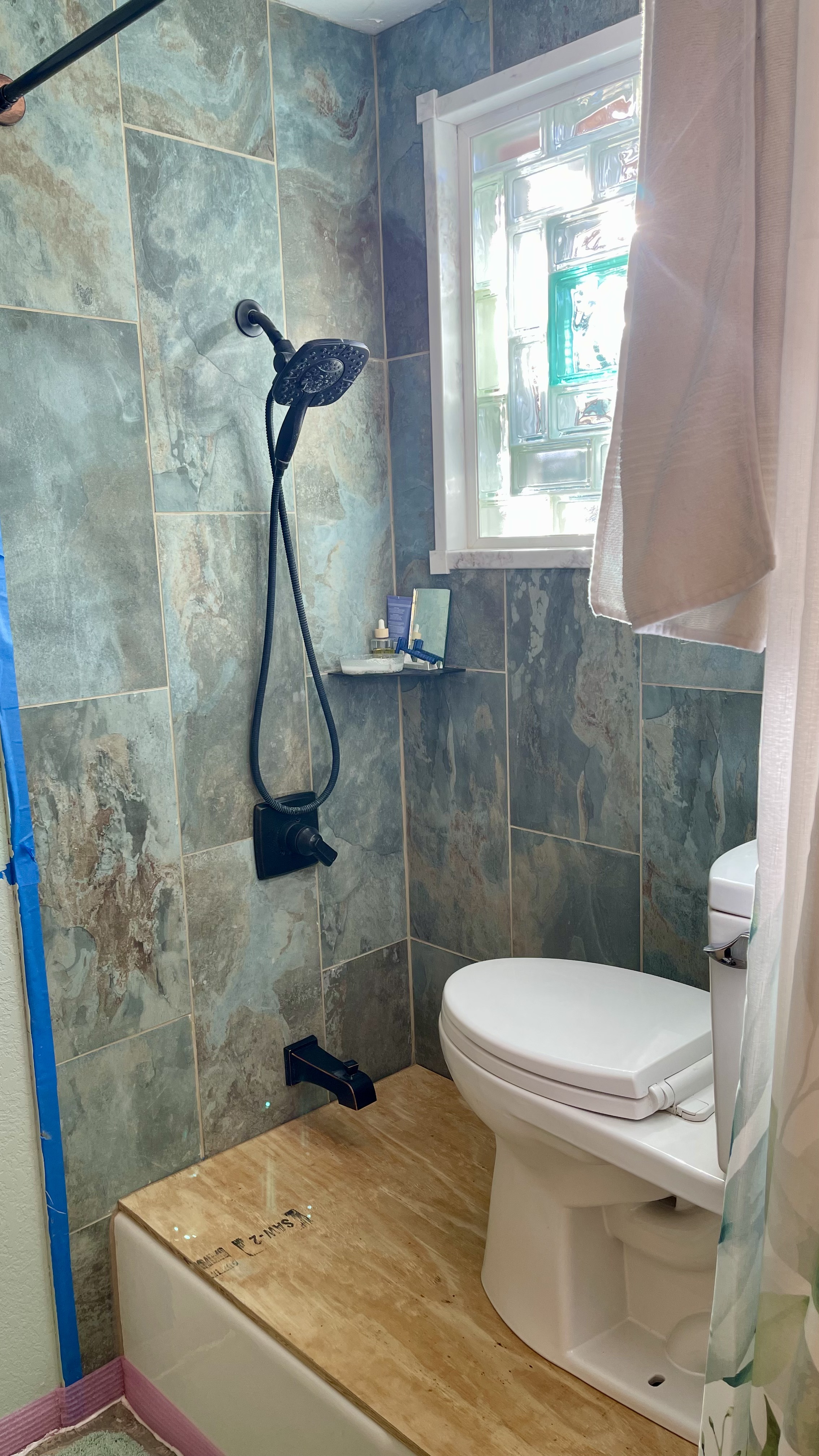

Finally I have started laying the tile! I foolishly thought I could finish in one day, but this is as far as I got until the old body ran out of gas. The tile saw is expensive to rent, so I plan to finish laying as many tiles as possible that don't require any cutting, then rent the saw one more time to finish up the edges and other areas requiring the tiles to be cut. I estimate I can lay down about 80-85% of the tiles before I need to start cutting to finish the project. (Those little orange wedges are leveling clips and spacers to keep adjacent tiles level with each other and prevent "lippage" and also ensure the grout lines are a uniform wide of 1/8th inch)
