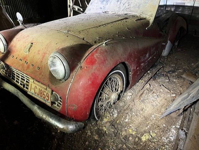

THE CAR

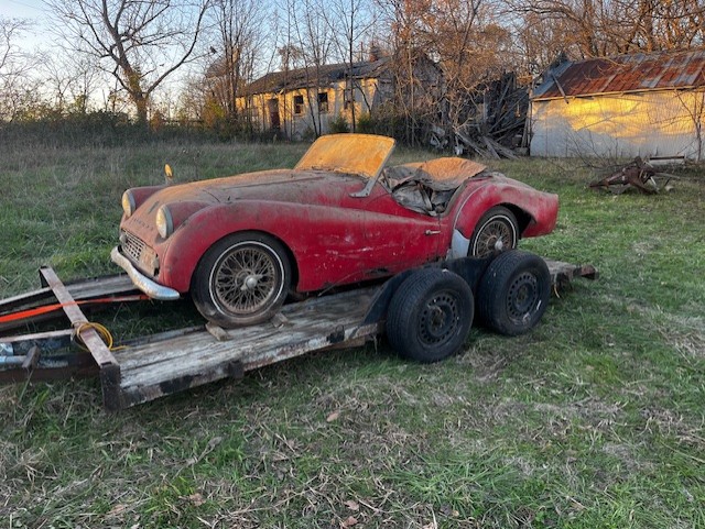

The TR3 A belonged to an older friend and neighbor of mine...he passed away and his wife later asked if I would want it. I have always loved the cut down doors and styling of the sidescreen TR's, and so I said yes and dove in!

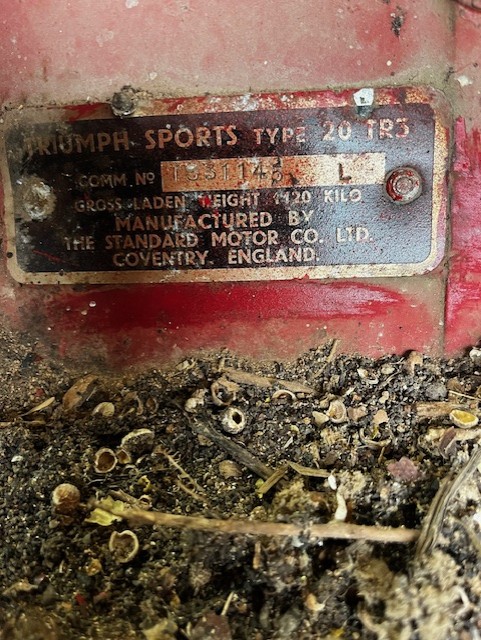

My friend purchased the car in 1972 I believe, while they lived in Kansas City, but shortly thereafter moved to Omaha Nebraska. They then moved near the Springfield MO area and brought it with them in 1976. He parked it in a barn and it never moved again until I pulled it out this past December. (2025) While he was alive, I had helped him work on it and fixed a few things on it, but he never did anything with it, not even transferring title or licensing it here in MO. It appears that it was pretty much 99% original, and had all the original items like covers, sidescreens (and actually a second set slightly different) most tools/jack handcrank etc. No bondo or previously repaired damage (though I may still find some). Rear overider and left fender slightly damaged. And front bumper not great and no overiders on front. I believe it has had a fresh coat of paint over the original, but only the outer panels repainted as far as I can tell. Inside of boot and bonnet, and inside of doors and under dash areas all appear original paint. There is a problem with the VIN I am working on. The car title from Nebraska appears they used the engine number instead of the commission number! (and actually placed a K suffix on it for some reason?? Couldn't read clearly b/c dirt and grease???) I got the BMIHT heritage certificate, and according to them the Commission, engine and body number are correct.

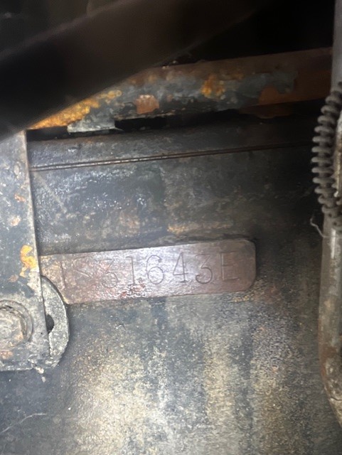

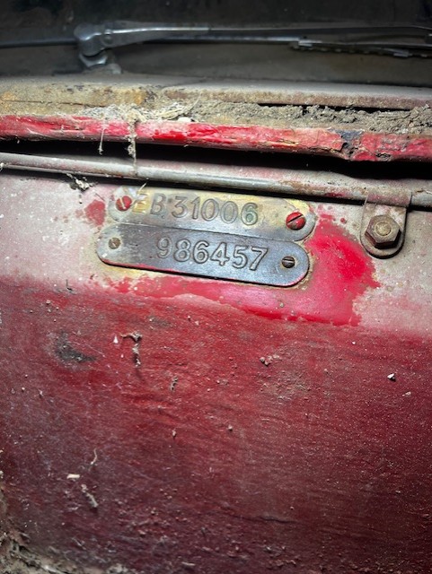

I was able to get ID/OD and used the engine number as vin for Missouri title for now. At some point I will need to get a corrected title with the commission number as vin as it should be.

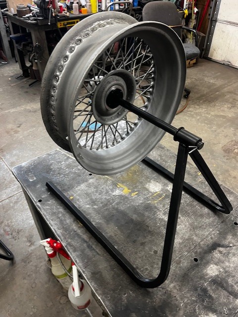

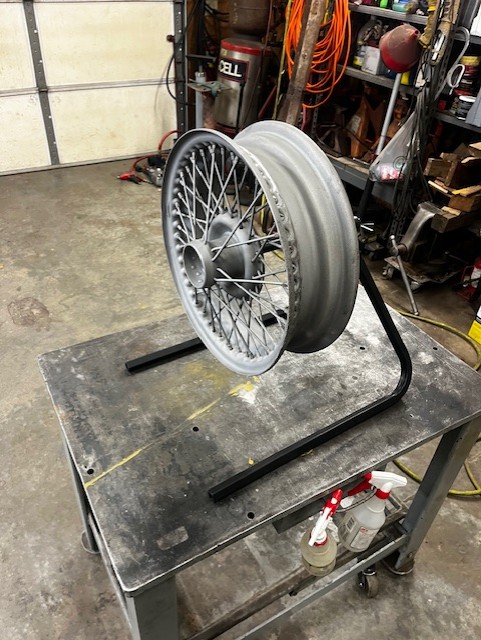

Started with wheels and tires so I could mount and move frame easily. It still had the original spare tire, and was holding air!!
Sandblasted, a few spokes replaced and trued, and epoxy coated and painted. Sorry, forgot to take a pic with new tires mounted. Maybe add later.

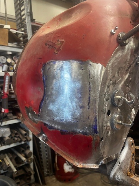

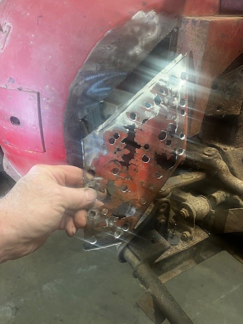

Decided to start learning my new sheetmetal skills at the front. Passenger side was all done with MIG, and did the driver side with TIG. The areas with the body mount doublers weren't too bad. Tedious because I was trying to limit the future sandwich rust problem. I then moved to the doubled reinforcement plate area for the front overrider supports...this proved a little more difficult as I was dealing with domed surface and had to figure out how to shape the metal. First one was sandbag hammer form with shrinker...second I made a hammer form and was able to complete it without having the shrinker teeth marks to deal with. Extra steps here also to limit future sandwich rust. (coated with weldthru primer before spot welding doubler, then mixed and applied epoxy primer spraying thickly on edges and worked in excess with a paint brush to force it in seam...after body sandblasted I will go around all areas with seam sealer. Also, the hole where the bolt goes thru will need to have some seam sealer forced into the seam between panel and doubler plate!) Photos to follow later.

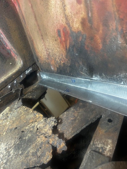

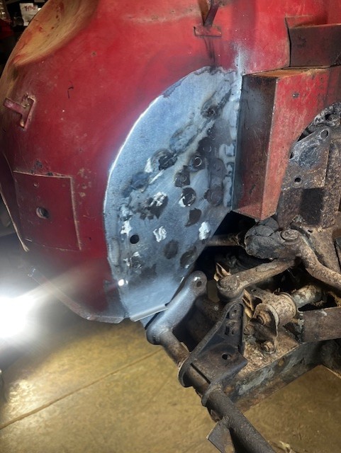

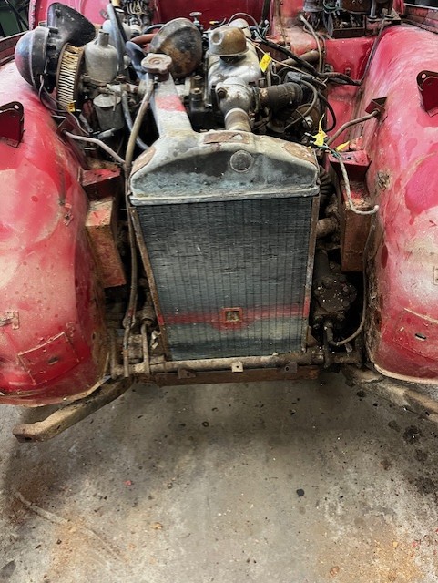

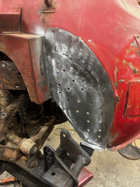

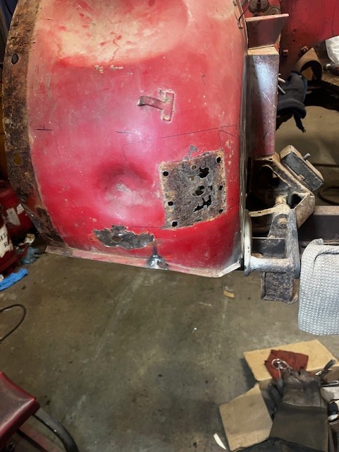

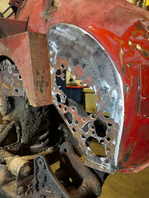

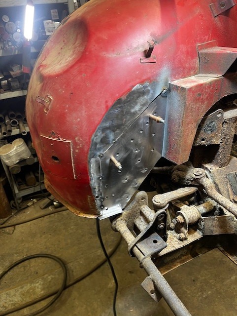

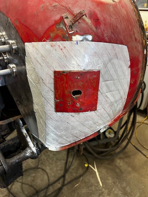

Here are some pics of the repaired areas on the front of the inner fenders...the body mount and overider doublers. Didn't try to "metal finish" so will need a very slight
coat of filler. I think my research indicates maybe a fiber reinforced for the first coat to help waterproof any pinholes. I held a light behind and welded every one I could find, but I'm sure MIG or TIG might leave some tiny holes somewhere! As stated before, used the passenger side to practice my MIG skills and get it dialed in, then did the driver side all with TIG.

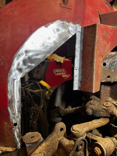

Passenger side rusty section cut out...
and repair stages...
and driver side. Rust before cutout and new repair panel welded in and prepunched for plug welding doubler.

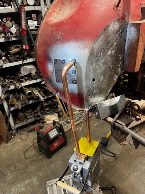

Overider doubler area repair...
And doubler...was able to use HF modified spot welder. Worked very well.

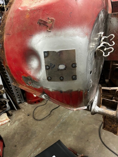

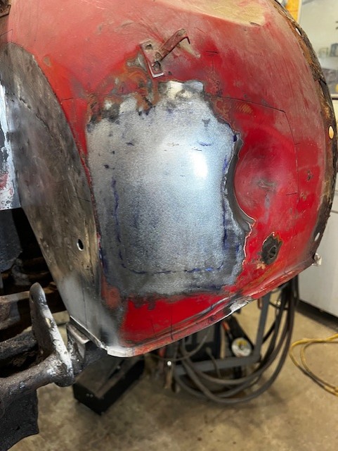

Decided to try my first flexible shape pattern making on this one. Didn't really need to get that elaborate for this area, but when I get to the complicated curves of the rear panel repairs I feel I may need to use some there.

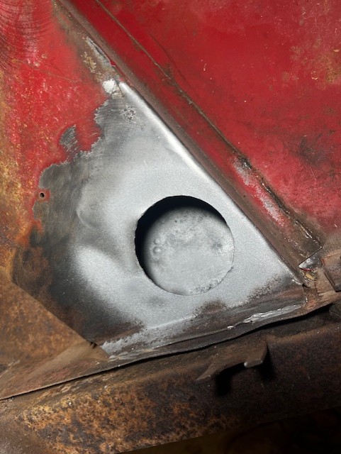

I am currently overthinking the boxed section repair of the access hole I created. Would like to do something to add some rust protection inside, but am in an analysis paralysis state as I research all my thoughts on how to go about that. Internet and forum research to support or nix my ideas only leads to confusion as there are so many limitations to each method, and no good consensus on the "best way"...
Some ideas I am entertaining...
1) Do nothing...not a lot of rust problem appearing except a few areas of mild surface rust currently, some 68 years after the leaving the factory! But I will have to weld in my hole patch, and the backside of the weld will be inaccessible and prone to rust I believe...Cavity wax maybe after paint is finished??
2) Clean up deep areas of loose paint/rust with a steel cable slighty frayed at end in a drill. Then I can go in with a body wax gun/tube and apply...??? Well, that's the fork in the decision tree I can't seem to decide on. Some options appear to be...
a) Use wax gun/tubes (or brushes on semi stiff wire on the side I holesawed the access hole) to try and apply epoxy primer...hard to prep area except the loose frayed wire...and not sure about the longevity of primer without a topcoat?
b)Same application techniques but use Ospho or Rust911 or similiar...then do I need to follow up with some kind of topcoat??? Epoxy primer (doesn't adhere well to Ospho unless the Ospho is neutralized first), Oil based paint works well over Oshpho, but maybe hard to get to spray thru wax gun/tube. Not sure about the Rust911...just started using it on some items after years of Evaporust use...but each (I think) would require cleaning and a topcoat...
c)Probably the one I'm going to settle on...spray Ospho best I can into area. Let it dry and crust over. Add cavity wax after car painting is complete and see if it lasts another 68 years!!!
OK...that's enough for now! Opinions and ideas welcomed!! Sorry for the long spiel, but sometimes helps me to share this stuff with others that "get it"...and my wife's eyes roll after my first 10 words usually!!!

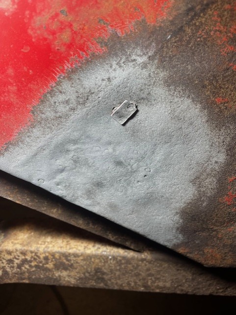

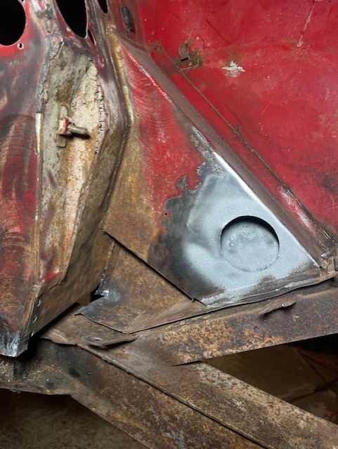

Here is the bad looking dent repair I was talking about earlier along with the access hole in the boxed section. I suppose I am fortunate that the original damage wasn't all that bad and no real rust anywhere other than surface rust. I'm leaving access hole open until I decide for sure how I am going to treat the inside area. I am planning on using the cavity wax gun and extension tubes, and probably tape over access hole temporarily, then working tube in thru the small areas available and giving it a spray with some Ospho. Then use the access hole to inspect and see how it covers. The results may lead me to further decisions about best way to treat.

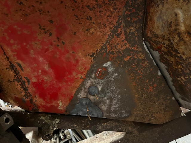

If you notice the small welded tab on the outside part of the inner fender, I posted a question earlier too see if others have these on theirs and if anyone knows what the original purpose was. So far one person mentioned it is on their car, but purpose is still just a guess. Maybe something to do with the assembly line? Now that I have access to the backside, it appears to be a factory (or dealer??) drilled hole, then this tab was welded on to cover the hole. The hole was 3/16 to 1/4" diameter. Almost like an opening for a cavity wax tube...but I did not think they had such a product in 1958...
Any guesses??

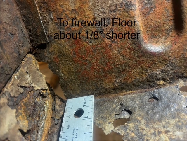

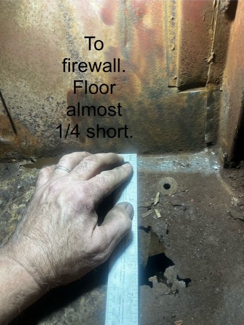

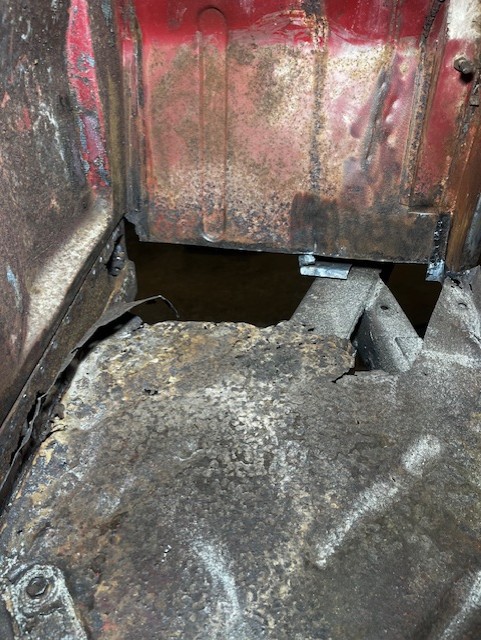

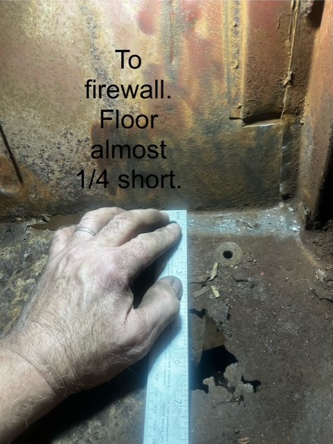

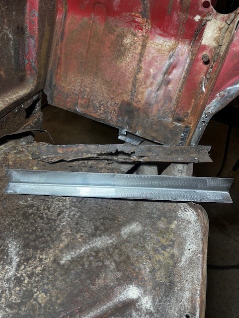

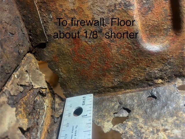

The floor and firewall repair that I started before pulling off to tackle the inner fender.
I cut out a small area of the floor for better access to the firewall. I am still not 100% clear on some aspects of the inner sill and floor replacements. Have watched several Youtube videos and have the restoration book of course. Have also read many great posts on this forum. I want to try and do as much as possible while on the frame. The gaps on the doors (and boot and bonnet for that matter!) were all pretty good as they were. So lots of measurements and maybe some templates and jigs for location, then would then like to remove the floors before adding the interior bracing as I don't crawl around and over stuff quite as easy as I used to! :p The sill, a and b post, front firewall and kick panels, and rear quarter sections I believe will all hold the shape without the floorpan. I can then use the old ones, (removed carefully) for measurements to trim and fit the new ones. (Will complete one side at a time, and test fit the tranny cover as I go. Will tack floors in place, with minimum if any to old sills. Then, after floors placed, I will add my interior bracing and cross bracing. Will then dive into the inner sill replacements! One side at a time again...I think I can rig up my gantry crane to lift the tub straight up far enough to work old sill out and new sill in. Or can jack and block one side at a time. Any critiques or recommendations on these steps would be highly appreciated!

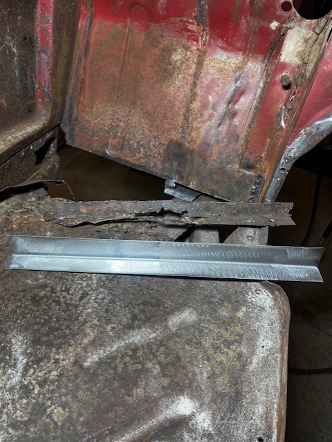

FW patch fitted and awaits welding! Removed part of floor pan for better access. Got my new floor pans in, but only one inner sill...other on backorder for another month or so. :(

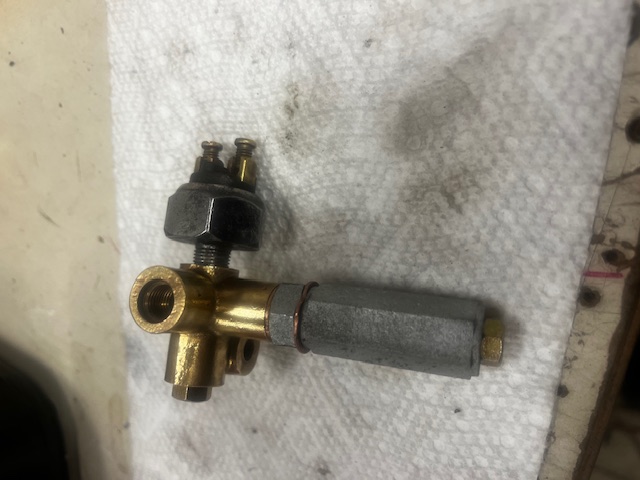

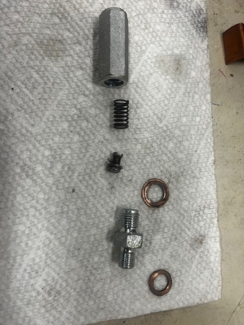

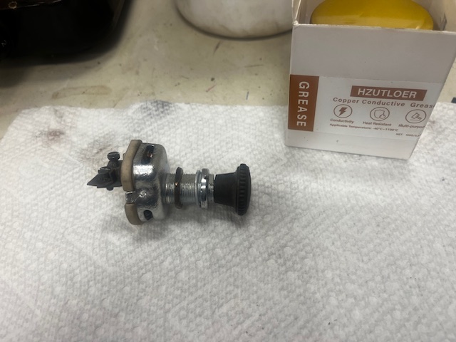

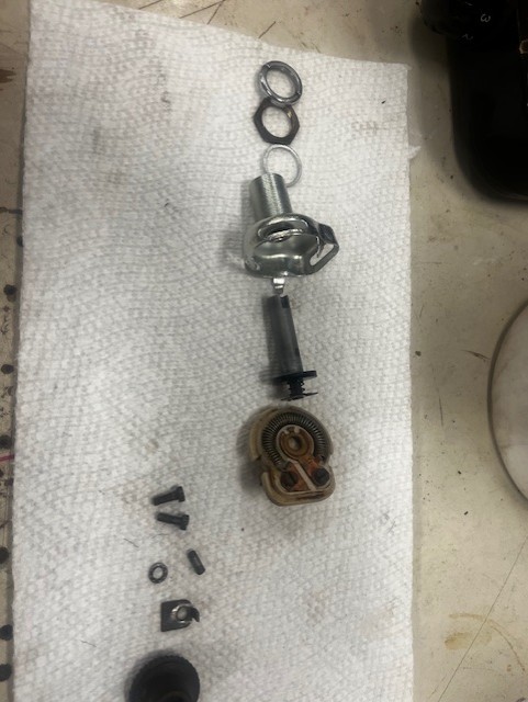

Decided to fiddle around with my electroplating and did a couple small projects..
Fan switch...
And the Brake restrictor valve...
I am not really going for a concourse car, but I enjoy the challenge of getting things close to original. Not 100% sure, but I believe the finish on the restrictor valve was probably just the metal as originally machined. Got pretty rusty after 67 years! :p
I should probably just have cleared it and moved on, but since I was playing around with my zinc coating, decided I'd coat it. Not sure how long the zinc plating will last until it starts rusting up, so maybe I'll clear over it any way! Played with trying to get a not so shiny finish on the main body...think it turned out ok.

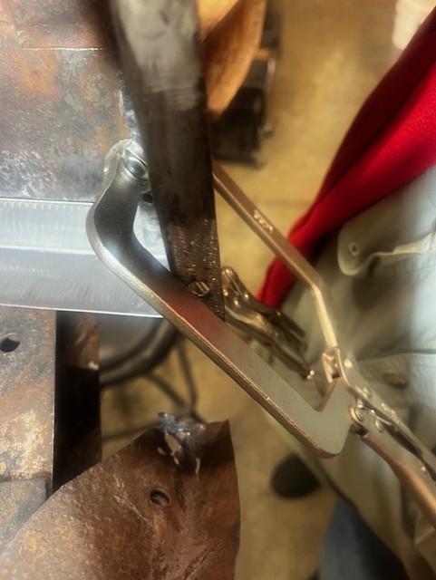

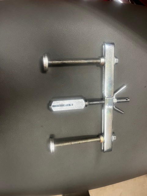

Manual dent puller for the stud welder studs..
And of course had to zinc chromate it! This works great at gently pulling up the metal in a controlled manor, instead of banging at it with a slide hammer. Have to say that the tool idea is not my own...saw one someone had made and thought it worked pretty slick...

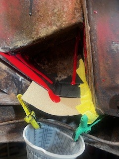

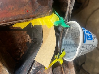

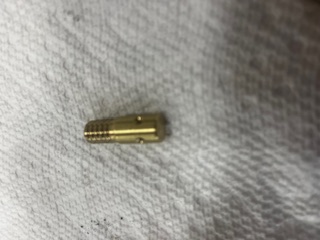

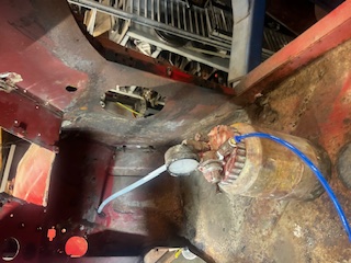

So...way too much time and effort into this next little(?) project...but once started I was committed to see it through. Not sure I'd do it again though! Tackled the two boxed in mostly inaccessible areas on the front inner fenders.

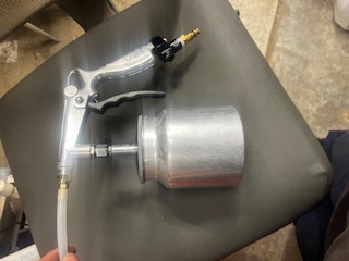

Made a new tip and used this cheap cavity wax gun...drilled access holes through firewall and applied Ospho. Followed shortly with lots of rinse water. This worked great!! Basically used the Ospho as an etch. Probably could have just sprayed the Ospho and left it at that (what I would do if doing this again I think!) That would have given me some additional rust protection. But I wanted primer and paint!!! (Side note...I used a boroscope and checked out the inside before starting this endeavor...was actually not much rust other than a little surface rust!) I just used the Ospho as an etch, as I could not do any prep to the Ospho treatment, and the bonding between Ospho and expoxy primers is touchy. (Not all primers can be used over Oshpho, and some are not even supposed to be used over any etch treatment!) Next tried using the wax gun to apply the epoxy primer. THAT didn't go so well!! After experimenting with several tip configurations and air pressures and other stuff, the epoxy was just too thick to spray thru tube. It would spray a bit, but once it filled up the tube fully it produced too much back pressure on the venturi pick up and it would just not pick it up. Thinned the epoxy as much as I could comfortably and still no joy.
So...onto plan B...
Dug out an old pressure pot HF HVLP sprayer and McGuivered it! Took off the HVLP spray gun, attached the wax gun tube with a new end tip with 8 holes, restricted the pickup tube inside diameter, added a footpedal because I needed both hands to guide the tube in and out and to different spots in the cavity (and move the pot around). Worked pretty well but oh what a mess! The excess ran out any open areas. Wasted a lot of primer and paint on the first side. (Guess the upside is I think it flowed into any voids in the overlap seams!!) On the next side, I added a little "catch container" and recovered a large portion of the extra that ran out, put it back in the gun and sprayed again...and again...and again...

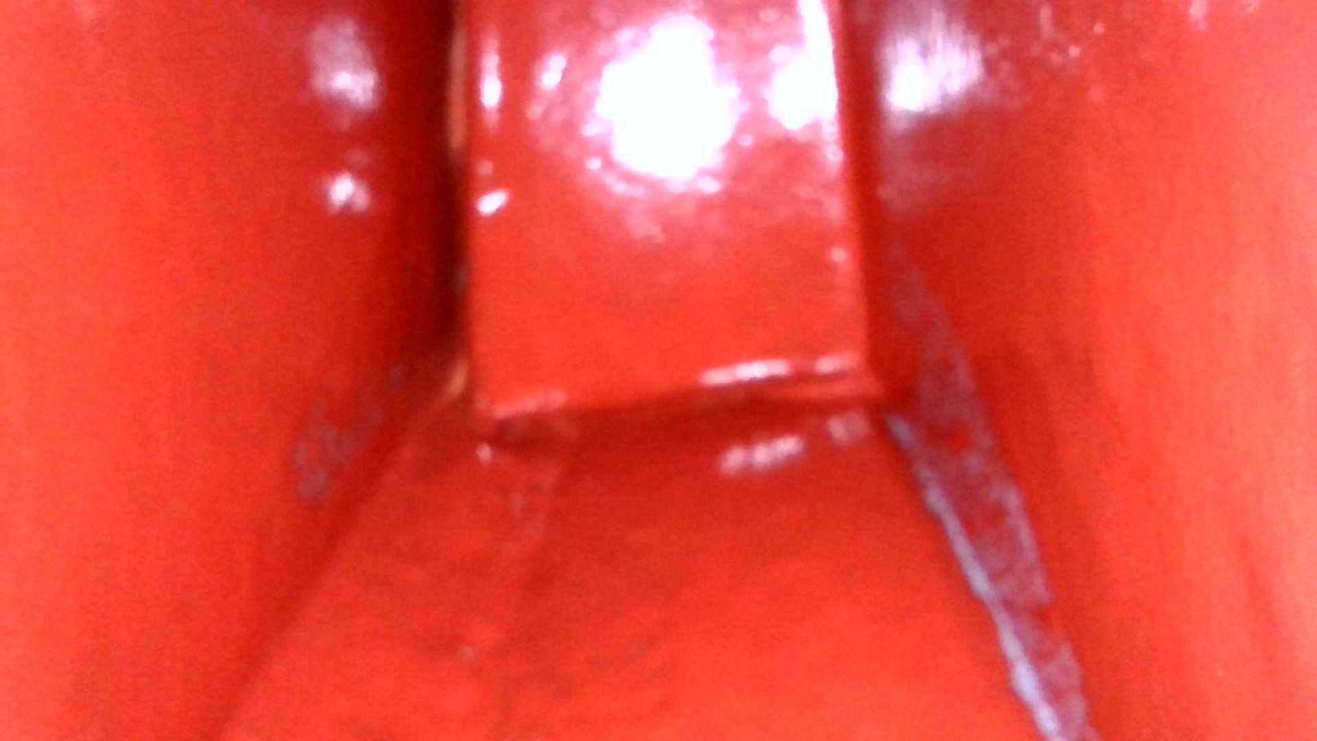

Here is a boroscope pic after my second or third "pass"... This was from the 1st side where I used a gray epoxy primer...you can see a small area that is showing a slight amount of gray, but otherwise I think it coated pretty well.
I used an infrared heat lamp overnight after the primer application and again after applying the paint.
The paint by the way is from my local PPG supplier...the first pic above with the "drip tray" is just a Shopline black epoxy primer. The red is a really good Signal red color match code, RAL 3001. (THANKS FORUM!) My PPG salesman and I came up with a PPG commercial coating urethane with that code match that is super tough!

Great job! The detail you are doing is new to me, again nice job. On the tool you made to pull dents, is the center arm some kind of chuck to grab a pin?
Steve
Steve
Thank you Steve. I'm not a professional body man so maybe others can chime in on the following...The stud welder gun is handy for spots that you can't access the backside easily to use a dolly, or hammer. The stud welder gun from Harbor Freight comes with a slide hammer with the stud quick grab attachment that you normally use, but it's kind of a brute force approach. Quick and fairly easy, but you can also pull too much and distort things further. Maybe if I had more experience with using the slide hammer I wouldn't have messed around making this puller. But I like being able to put a little controlled pressure on, then tapping around the outer high spots with a body hammer. The center section is just the end of the slide hammer from harbor freight. Metric thread. I just turned up a metric to SAE adaptor in the lathe, so I can use it on either the slide hammer or my little puller. There are similar arrangements that you can use that just use screws into the metal, but it creates more holes to weld up! I don't foresee lots of areas on the TR3 that I will need it for, but the couple I have so far it has really come in handy! I am not trying to "metal finish" this car, but I do enjoy learning the skills it takes to get it really close for minimum amounts of filler!
If you are thinking of getting the HF stud gun, they make a 110v and a 220v version. The 220v version is what I settled on after a ton of research on the forums and Youtube videos.
