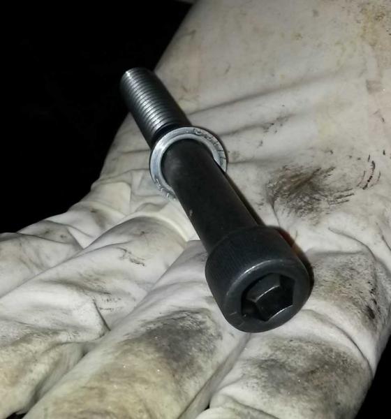

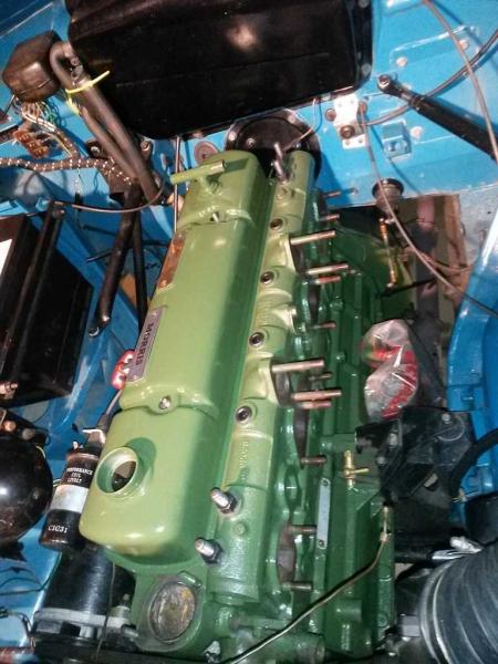

Here's a log manifold with the four centre studs replaced with shorter studs to stop the interference to airflow. The studs are accessed via threaded plugs in the holes at top of the manifold.

That's certainly one way to do it!
Since that appears to be in an Austin (?) saloon, I suspect that the sanctioning body does not allow the switch to a Healey's head and separate manifold, as they're certainly plentiful and easy enough to acquire.
Always somebody trying to build a better mousetrap :cheers:

This is a Morris Isis (not mine) from New Zealand. This is just a cheap way to have a bit of a play...Healey stuff is not cheap to obtain in Australia /NZ especially as you need different carbs too. The H4 twins are pretty easy to acquire, this Isis had a single SU originally.
You may note that the Gallery or log as we like to call it is enlarged (big log) compared to what would be on the first 2.6L Healey.This one comes from the later 2.9L C series vehicles.
