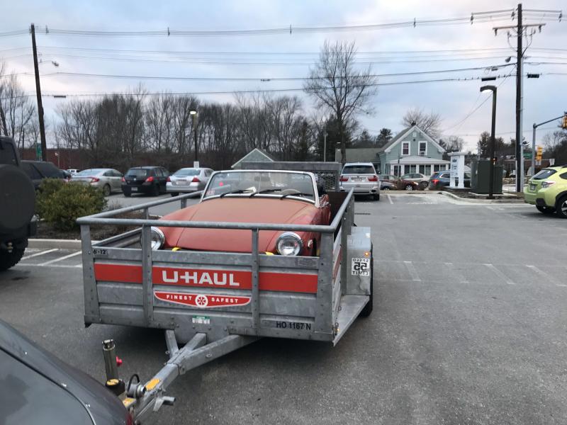

The day is finally (almost) here! Got the trailer rented and headed to pick it up tomorrow! I can't wait.....
on the way!
and another!

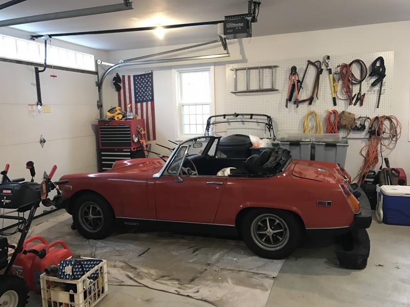

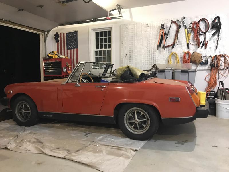

starting the cleaning :-)
Hurray! looking good
Woohoo! :cheers:
