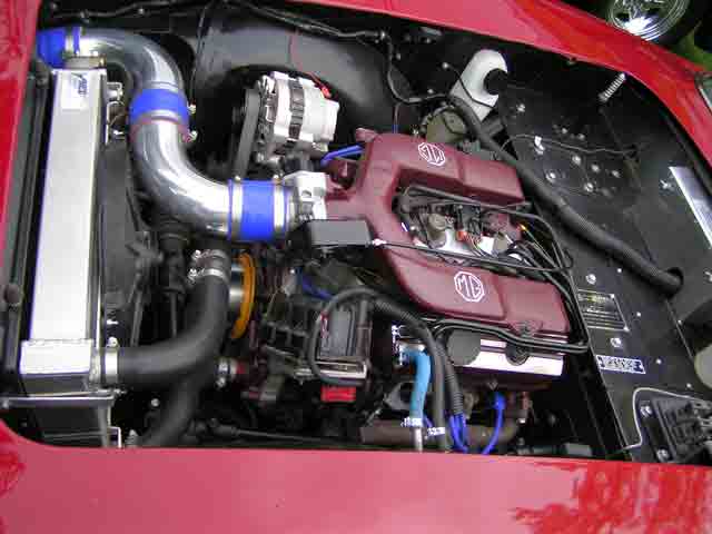

The same engine also fits in an MGA with a bit more work (this one looks odd because it has the Jamaican body on it)).
Thanks Bill for the Input. Love the engine setup in the photo.. I'll keep you all informed.
