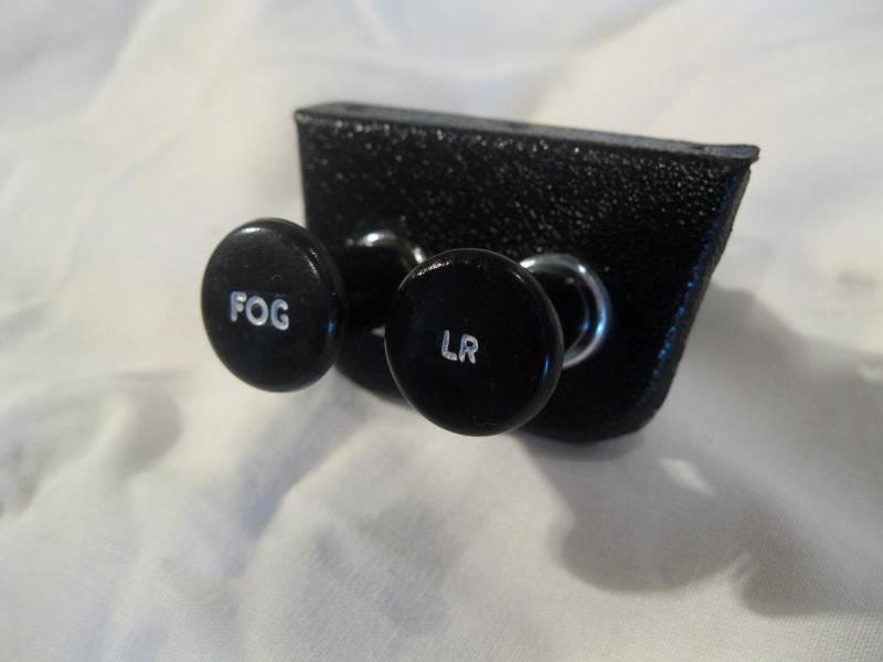

True, but it's huge! I wouldn't want that great big thing sticking out of my dash.Use the vent pull knob on an original or repro switch. No marking on the vent knob.
Yep, your right, I forgot about how much longer it is.True, but it's huge! I wouldn't want that great big thing sticking out of my dash.

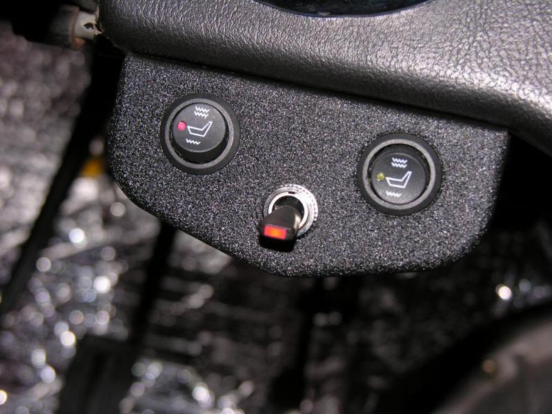

You could mount a switch under the dash without having an additional switch/knob in plain view.

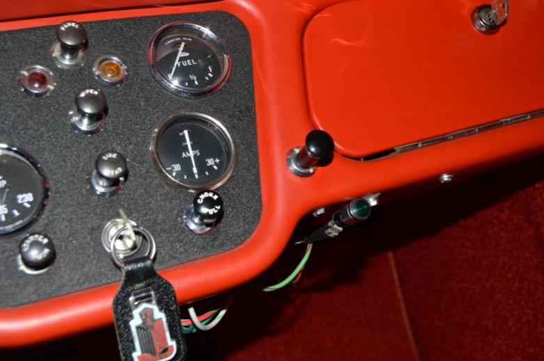

Note that the factory would have left the unused holes covered by vinyl. The DPO of my current TR3 (or his mechanic) evidently didn't know that, and drilled a new hole right between the two others. Not really a problem, until I added overdrive ...There are 2 pre-drilled holes on your dash- one for overdrive and 1 for a heater.

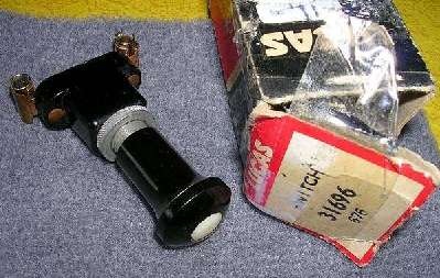

There are 2 pre-drilled holes on your dash- one for overdrive and 1 for a heater. If you don't have one or the other
of those accessorizes, you can use those holes in lieu of an extra bracket. The Lucas push-pull switch, similar to
your wiper switch, is quite often on eBay.
Moss, TRF and NOS Locaters sell an aftermarket version which is quite similar to the Lucas ones, but the bezel is incorrect. It's
chrome but has a period look if you're not fussy. As Randall says, sand down an extra knob that you might have, but better yet,
fill in the letters w/JB Weld, body putty or whatever you have. Then sand it & paint it.
Thanks, Randall. You just saved me from doing the same thing. My add-on overdrive switch is under the dash and I've just ordered the correct replacement and planned to move it to the correct position.Note that the factory would have left the unused holes covered by vinyl. The DPO of my current TR3 (or his mechanic) evidently didn't know that, and drilled a new hole right between the two others. Not really a problem, until I added overdrive ...
