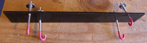

I was thinking of using "J" bolts to the spokes similar to GregW's attachment above but I thought the bead area would give a better reading as the outside rim had too many variations around the wheel. I would think just finger tight would be sufficient as we just don't want the plates to move during measurement. What do you think?

I think the attachment method would work well and I agree that standoffs from the rim would be preferable to leaning on the tire. I am following your approach with the exception of having the fixture contact the ground to support the insertion of slots for the tape measures.

What I did was use springs under the washers to get tension. Here is a better picture to show what I mean.
