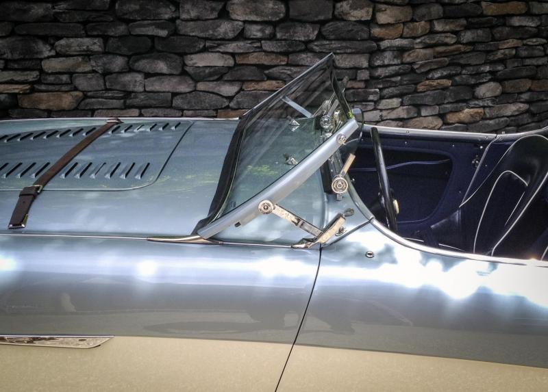

Perhaps some of you remember the "special windscreen feet" that we featured in the August 2014 edition of Healey Marque magazine. A resourceful member named Ray Juncal of southern California made some of these to permit lowering the Healey 100 windscreen to a sort-of halfway-down position that gave the car some of the dramatic look of the fully lowered windscreen while still providing enough wind protection to keep you from losing your hat! Here's what they look like installed:

Special Healey 100 Windscreen Feet
I love innovation, and Ray Juncal of Los Angeles has innovated with the best of them with the special “feet” that he has developed for the Healey 100 windscreen.
Everyone knows how fabulous the 100 looks with its windscreen lowered into “the racing position.” It looks fast just sitting still, and it is always a source of complimentary comments at car shows. However, all of us Healey 100 owners know something else: it’s not really comfortable to drive the car with the windscreen lowered. In fact, with the windscreen down, the air is directed right into your face. Even if you duck, you get it right in the forehead, and unless you’re wearing a face shield, it’s not comfortable and the threat of catching bugs and debris is ever-present. But gosh, the car just looks so good that way, it’s tempting to suffer anyway.
Enter a little thinking “outside the box.” Ray has made some windscreen feet with relocated sockets for receiving the pegs on the lower edge of the windscreen. The sockets are farther to the rear than the stock ones, and the result is that the windscreen is lowered less. In this position it gains much of the dramatic look of the fully lowered position, but it remain high enough to direct the airflow over your head.
Why didn’t someone think of this a long time ago?

Ray advises, “They may require some grinding or shimming to get them to fit. Some of the tests so far have been a bolt-in, but one required shims as the pins on the windshield were spaced too wide apart. I also have not had a set fitted to an early car that had the sand cast fender mounts, but I think they were only on the first couple of hundred cars.”
Note also that the windscreen holddown springs do not work with the windscreen in this intermediate position. If you do stretch them to reach it, they will not return to their original length and will no longer stow on the tonneau studs. However, I haven’t found the springs to be necessary, and after logging several hundred miles with the windscreen in this intermediate position, I have experienced no windscreen vibration or other problems.
