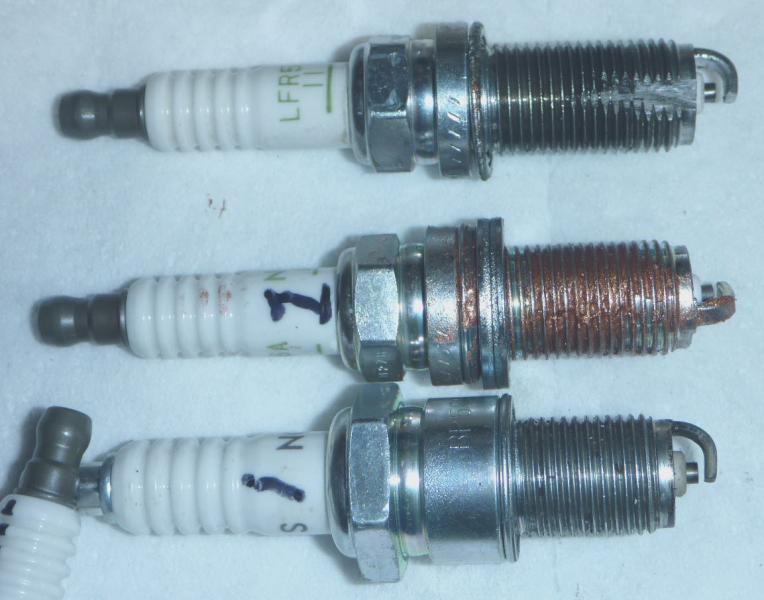

Andrea on this forum has been using extra-long reach NGK LFR5 & 6 plugs. The threads protrude into the 960 combustion chamber by 1/8" which I have measured on a friend's spare head.
Having some extras, I made one into a cheapo tap for cleaning the carbon out of the last few threads.
Picture shows this as well as the two .060" index washers required for the exact reach.
