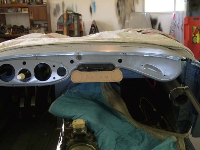

Here is a picture of the side attachment. Does your car still have these curved ends still welded to the car or have they been cut to make the BJ8 dash work. I had to replace them on a car with a custom wood dash in order to put back the factory aluminum dash.
Wow, that's rough.
The early dash is held on with a total of five (5) screws; two (2) at each end, as Jim shows, and one (1) through the dash in about the middle, to a bracket on the scuttle.
The bracket in the center can just be seen above and the the right of the two (2) rivets on the steering wheel at about the 2:00 - 2:30 position
This may be a clearer picture of the LH-end fasteners...
J

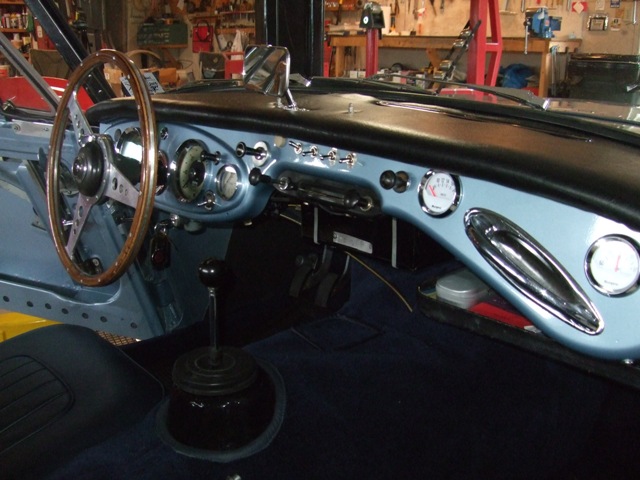

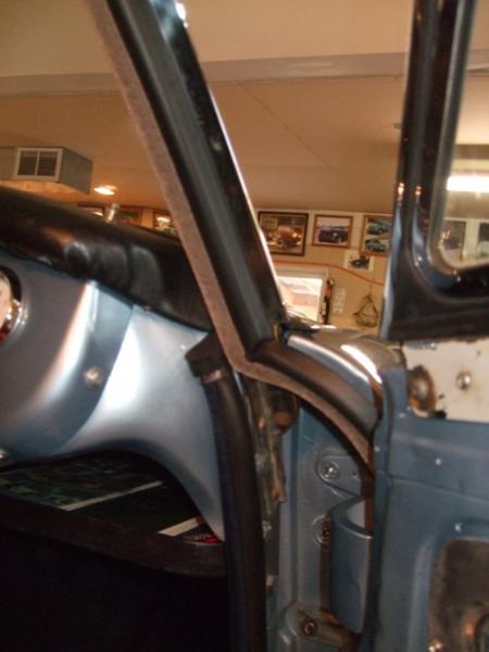

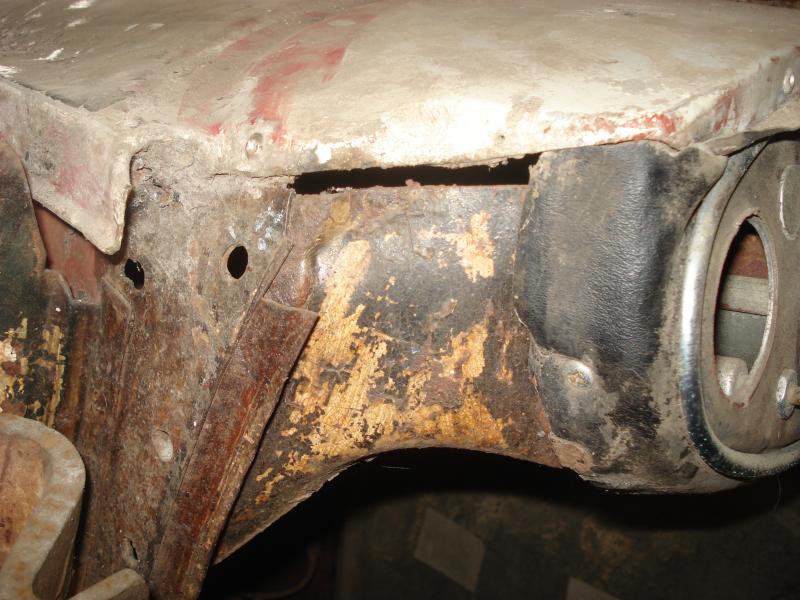

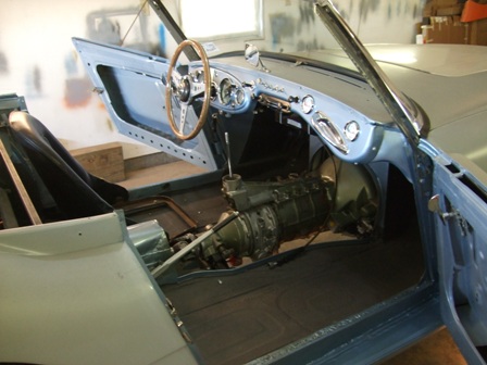

Here's some pics of my BJ7. You see the curved pieces on the ends and the small cream white plastic cap is covering the off center screw that screws into the brace. Its not factory original but then nothing I build is factory original.
