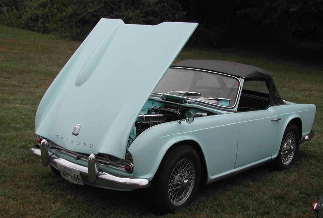

Cinneagh, was that you and your baby blue TR4 that I was talking to at the TRAC tech session last weekend?
Aldwyn, I didn't go to the Tech Session, but James Meechie (sp?) is the only one in TRAC that has a light blue (is it correct to say Powder Blue if it's a TR4?) that I know of. James is the one who schedules all the Tech Sessions.
The attached photo is of James' TR4 at the TRAC Picnic.
