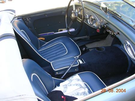

I took this picture of an Healey with an armrest in St. Moritz this year. I dont have an armrest on my Healey, but want one, thats why I took the picture. On the picture you can see that its attached with click buttons. I think I might use velcroue.

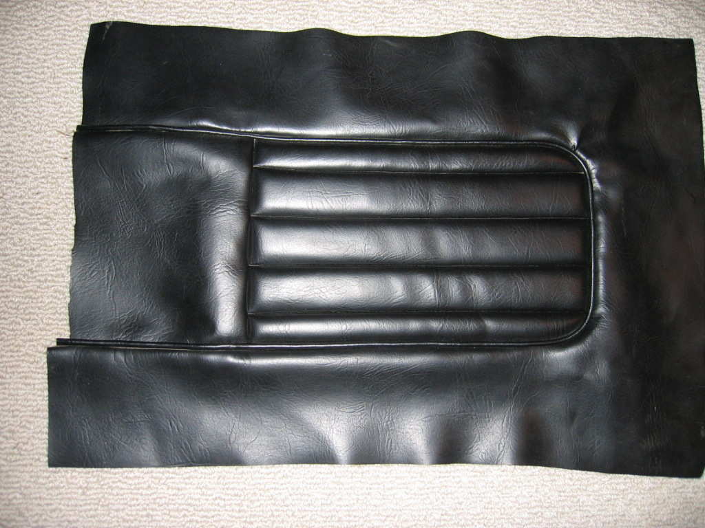

The armrest I have I purchased from ebay and it is neither the pad or saddle type but I don't know if it is the third type. It is wider than the pad type and is rounded in the front but straight in the back. It is padded on top but didn't come with any foam or other filler. I am not sure if it correct but may be the third type. I could send or attach a picture if you would be interested in seeing what you think.
Derek,
Here is the picture of what I have. It is 7.5 inches wide bead to bead and 13 inches long bead to seam. As you can see, it is padded but probably too wide for my 100-6. What do you think?

Its clearly not a saddle type armrest. Im no expert on the pad types but it doesnt like look like one of those either. I think they should have beading all round It probably isnt for a healey. In addition you would normally expect contrasting piping in white or red.
