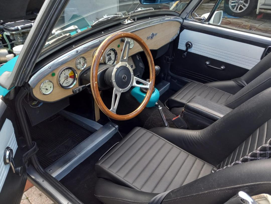

Besides the custom body work other upgrades include: The 1275cc MG engine was rebuilt and a street cam added; Electronic ignition; Weber 32/36 carb with a new header and exhaust system; a 5-speed Datsun transmission rebuilt by Rivergate; wheels are 13x7 with 185/70R13 tires. Tire pressure in the front is 22 PSI and the rear 24 PSI. The interior was completely redone and a modern radio/speaker system and cigarette lighter plug installed. A center console/storage area/arm rest was also added. The indicator, running, and stop lights use LED bulbs.

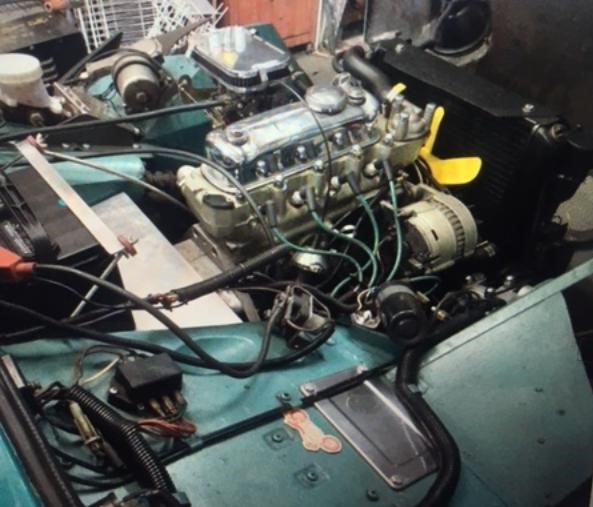

The Arkley's 1275cc MG Engine and clean, uncluttered interior:

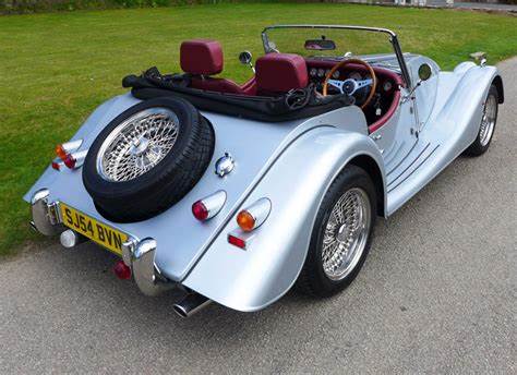

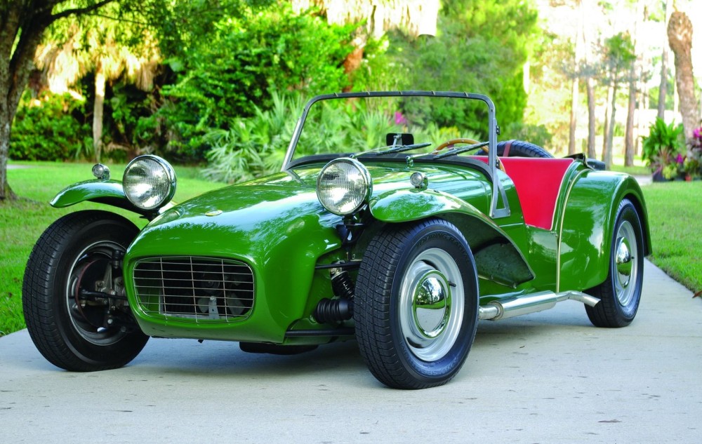

Lotus 7 front clip Morgan rear end
