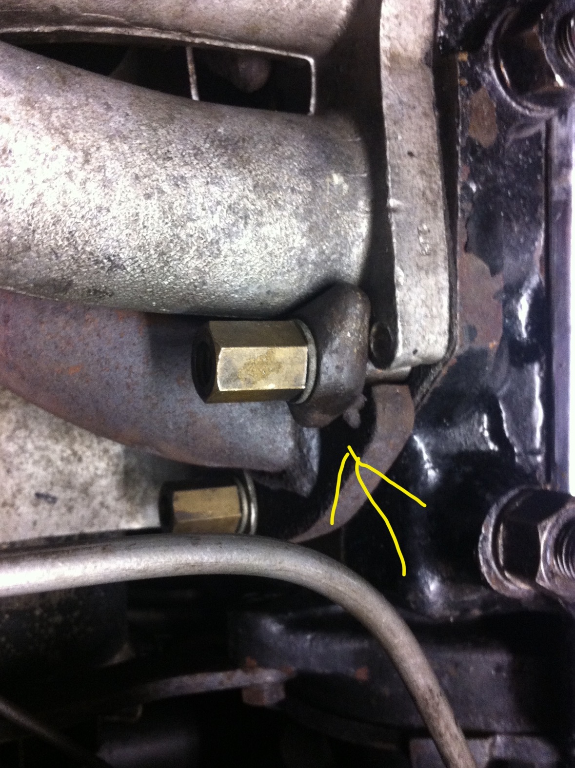

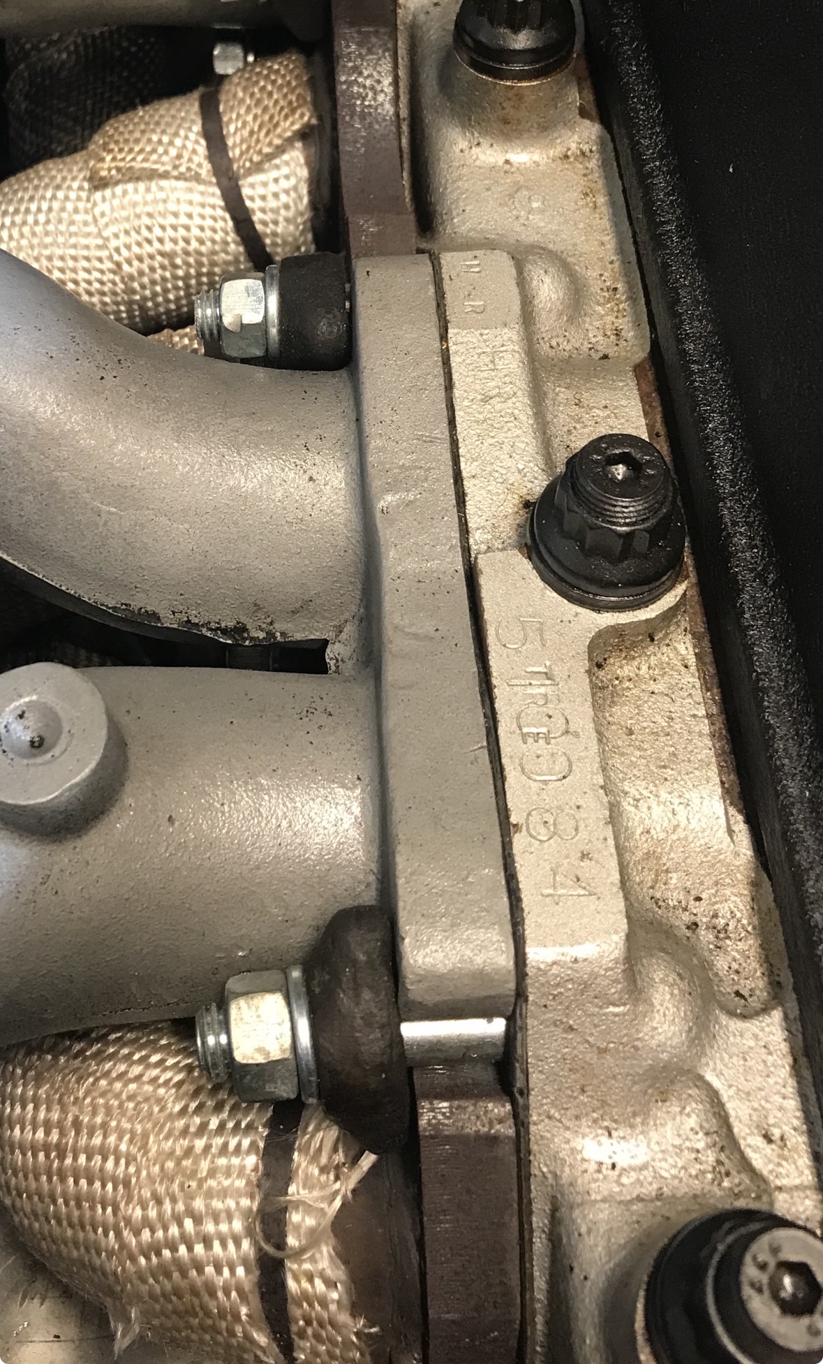

Some of the after market exhaust manifold plates are thin.
But the typical effect is that the exhaust is loose to the head as the football ( your type of football) shaped clamps tighten to the thicker inlet manifold first.
The typical fixes are to put a blob of weld on the exhaust manifold to raise the needed clamp area.
And or
Grind off the inlet side of the clamp enough to clamp both inlet and exhaust.
Some tack weld a small nut to the exhaust side on the clamp.
The first picture is an early set up I had with Su carbs and a 1970’s after market exhaust with thin plate to the head. With built up welds.
The other picture is my Weber set up with Phoenix big bore exhaust manifold and you can see they are close enough to equal thickness.
Karl
