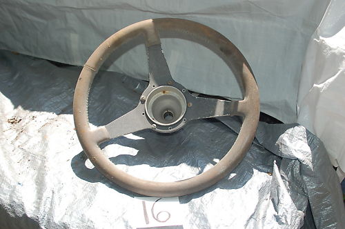

Anyone have a Pic of a Momo steering wheel on a 3?
karls59tr
Bronze
Did the Momo wheels from back in the day just tighten to the shaft by a bolt and could you mount the trafficter in them? Also are the TR3 and TR4A steering shafts the same ,in other words can you mount a TR3 wheel on a TR4A or vice versa?

I think the answer is 'no' across the board. IIRC the MoMo wheels used a application-specific hub that attached to the shaft using a nut, just like the original steering wheel. There were some other aftermarket wheels that would keep the control head, but again IIRC, not with the Momo. And I believe the R&P cars had a different fitting for the steering wheel than the earlier cars did.

Randall That picture of the wheel on Ebay is why I posted here. Trying to determine if that is actually a Momo wheel and if it would fit a TR3? Do you think it is?
