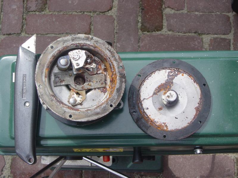

I did mine some time ago. From '67 and looked rusted but they are working again.
attachment.php
