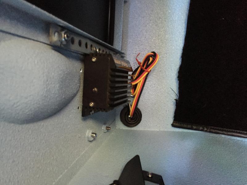

Any reason not to mount this here?
Rut
I'm trying not to make the modern upgrades obvious to the casual LBC guy and hope it's ok to mount the Crane XR700 inside the passenger footwell.

I mounted mine on the cockpit side of firewall under the dash on the passenger side. Out of sight. I then wrapped the wires in a black hockey shoe lace with blue tracer.

Dog, horses, sheep and cattle mount. Fit, or fitting is the correct term. Yes, out of heat and moisture is best.
Check the manual and be sure it is OK to mount it upside down.

I mounted the box using heavy duty Velcro. Here's a photo of the cable coming through the firewall.

irregardless of the semantics. the electronic ignition box on the 1500 is mounted on the drivers wheel cover - so, passenger side would not look completely out of place - though I do like the stealth location

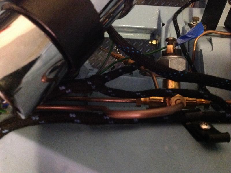

I received my hockey shoe lace today and wrapped the wires after I mounted the box and although mines in a different position than yours it looks like it belongs there! These tidbits of information are priceless and hopefully they are archived somewhere that will stay around long after we're gone. Thanks for this tidbit and all the other things you've shared over the years!

They are just giant shoe laces and I cut the tip off, expanded the cut end, and ran a torch along the cut edge to seal it. They work great for just about any bundle of wires up to about 8-10 and once installed you pull it tight and it snugs up really nice. You really have to look hard to tell its different from the wiring harness!

So Rut we want to see Pics.

Not much to show, but I positioned the newly covered wires next to the wiring harness for effect.

Pretty Good Match Rut.
