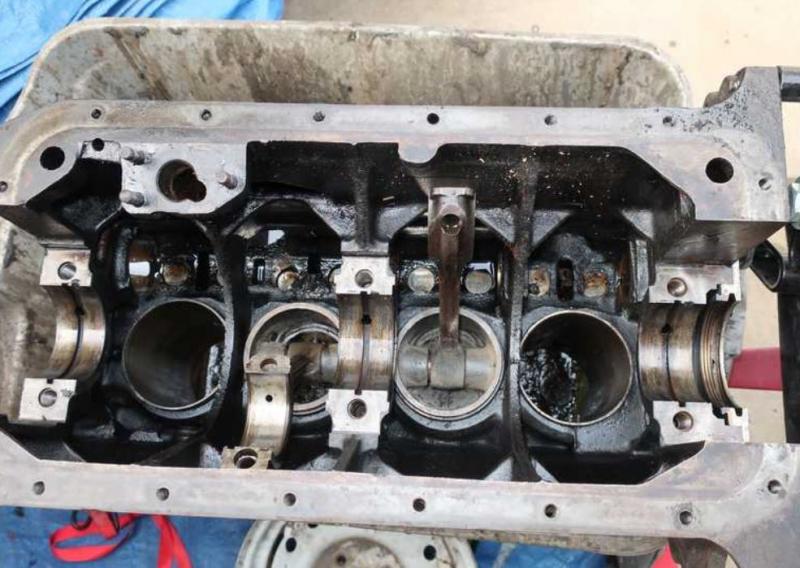

I'm working on a second engine, which came with my TR4A. It's a TR4 engine. I'm at the point of removing the cylinders, but they are really tight. Pounding away on a wood block hasn't worked, nor has using an aluminum block instead of the wood. I am reluctant to be more aggressive, as I don't want to risk cracking the block.
The problem is complicated by the fact that two pistons are seized in their cylinders. For that reason, tricks like making a puller won't work, at least not on those two cylinders. I'm thinking of pouring something into the coolant area, maybe phosphoric acid or a weak solution of muriatic acid, and letting it sit for a day. Or, something like that.
Any other, maybe less scary ideas? I don't care about the cylinders or pistons; obviously, they will have to be replaced.

I got the li'l buggers out!
I found a piece of aluminum that was about the right size, used it as a drift, and gave one a whack with a small sledge. After a couple hits, I could feel the first one moving a bit, and it got easier as it moved farther. The rest required about the same effort.

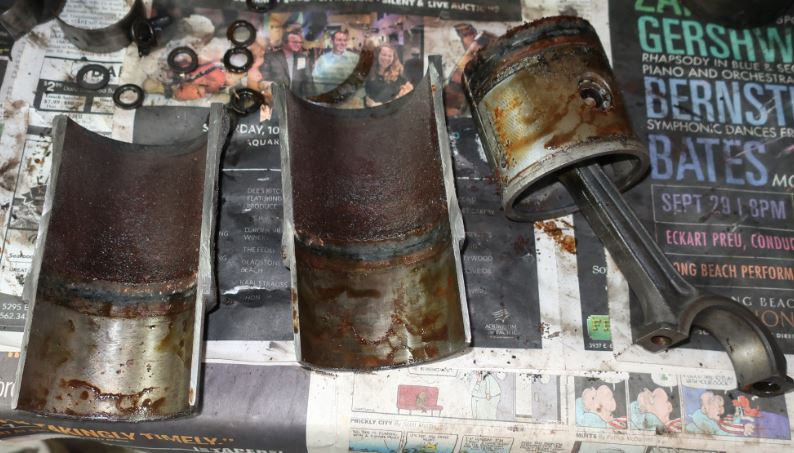

I still have two pistons stuck in their cylinders. One is no longer frozen, but it will take some force to get it out. I will try my press on them. If that doesn't work, I'll cut the little mothas apart with an angle grinder and cutting disk. The only things I need are the connecting rods; the rest is trash.

Use the same sledge on the crown of the pistons and they'll break out in one big whack!
In the end, I just cut the cylinders with my angle grinder. Took about a minute each, then just a tap with a hammer and chisel to break the halves apart.
