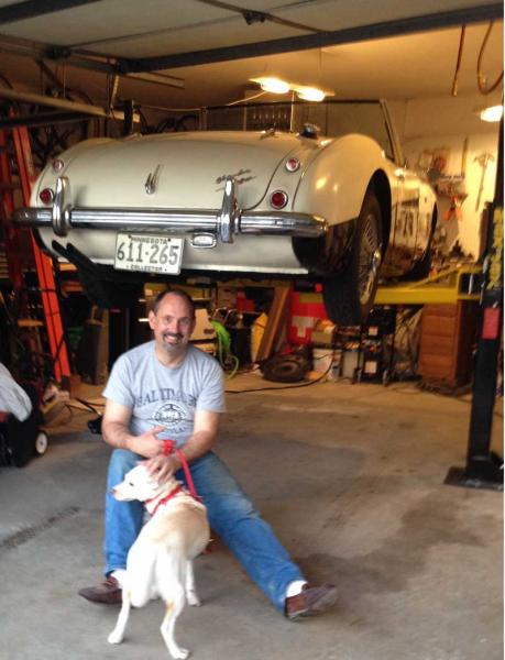

Here's our Healey on the Maxjax. The ceiling is 9' 6", and the Healey doesn't get anywhere near it.

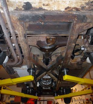

Total access down below...

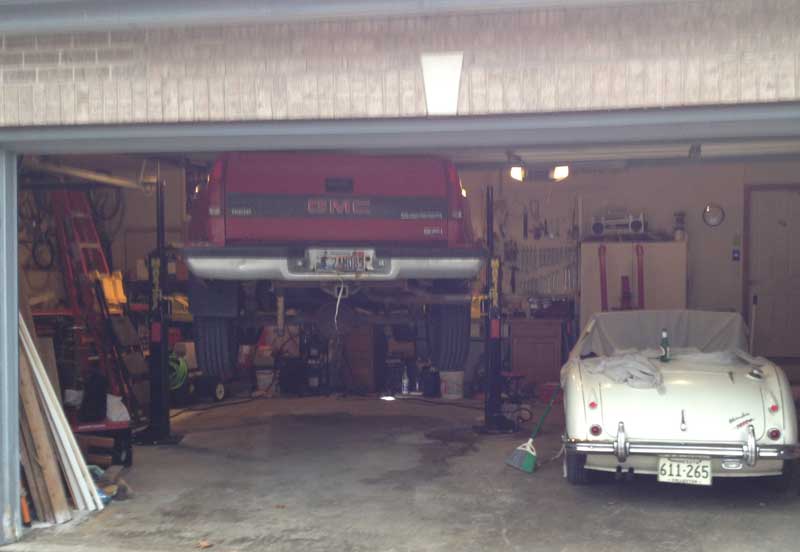

I can even run the truck all the way up. It's a bit close!

I just couldn't seem to find an underall view showing the whole car on the lift, but this is representative of the complete access:
