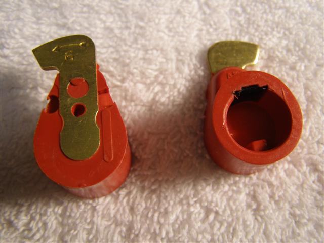

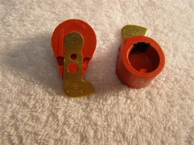

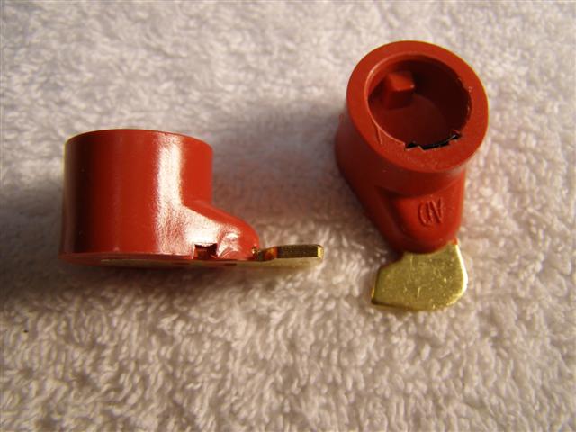

Jeff from Advanced Distributors has been very disappointed in the quality of rotors and caps as of late, so he is making some of his own. These are two of the first, one of which will be hitting the road as soon as the weather clears.
I have NO FINANCIAL INTEREST, but want these problem parts eliminated and replaced with good parts like these.
New Advanced Rotors

Ok, I know this is going to get asked, so here's the deal.
1. The rotor contacts are thermally bonded so there is no rivet that will internally short to the shaft or come loose.
2. This particular red resin has a thermal expansion rate that's about 1/10th of the typical black plastic rotor. That means they fit tight to the shaft even when hot, and the expansion won't make the rivet fall out (again, no rivet!).
3. The fit to the shaft is literally perfect. Any tighter and it would be a problem fitting them and any looser it would be like the made in Italy version which can rotate slightly on the shaft.
4. There's no carbon content in the red plastic as there is in black. That means these rotors will be far less likely to lend themselves to a misfire. The composition has zero components that convey electricity, with the exception of the obvious solid brass contact.
5. The contact has an exaggerated rounded trailing edge which can help eliminate misfires caused by phasing issues, fairly common in the TR6 distributor.
I don't mean this to be a sales pitch, just the improvements made over the "readily available" stuff. If you're tired of rotors failing, here's the solution (many, many months in the making.)
Nice job Jeff. I would buy a gross but don't think they'll fit in the Unilite Mallory.

Would these rotors fit the stock GT-6 distributor as well?
My GT6 uses a Delco distributor... but if you have a 25 or 45 series Lucas distributor I would think they should fit.
No, these rotors don't fit Delco distributors - strictly the 22D, 23D, 25D, and older miscellaneous 4 and 6 cylinder vehicles including a few various tractors, etc...
They DO NOT fit the 45D distributors either. Those take a different specific rotor that I have available in blue.
