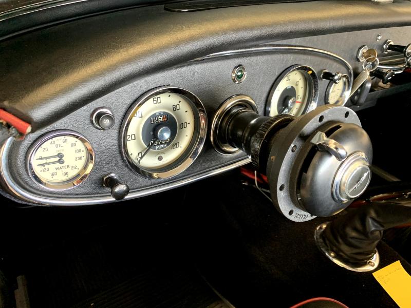

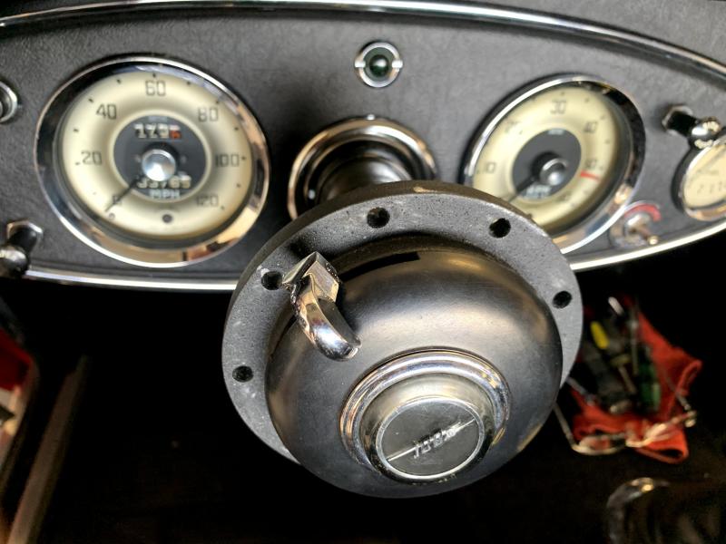

So, yesterday I got in my car, prepared to start it and noticed that the turn signal lever on the control head was skewed to the left. I have not worked on the steering box at all and have not messed with the steering wheel. I also don't recall knocking or striking the lever/control head to force it to the new position. I have a Moto-Lita wheel installed with the adjustable wheel on a BT7.
I understand that the fix is to loosen the nut on the end of the stator tube, grip the tube and then slightly rotate it to get the signal lever back into proper orientation. I assumed that the nut must have loosened slightly over time permitting the rotation of the control head; However, when I checked the nut and tube at the steering box, the nut was very tight as was the tube. How does the control head rotate if the nut is tight?
Before I loosen the nut and rotate the tube to fix this I wonder if anyone can help me understand what might have caused the head to rotate in the first place? As I understand things the grub (set) screws effect the inward/outward movement of the head, not the rotation. I would like to try to understand this before adjusting anything.

I should have also mentioned, the control head is not free - it does not spin or rotate. Everything is as it should be except that it is skewed to the left. Puzzling.

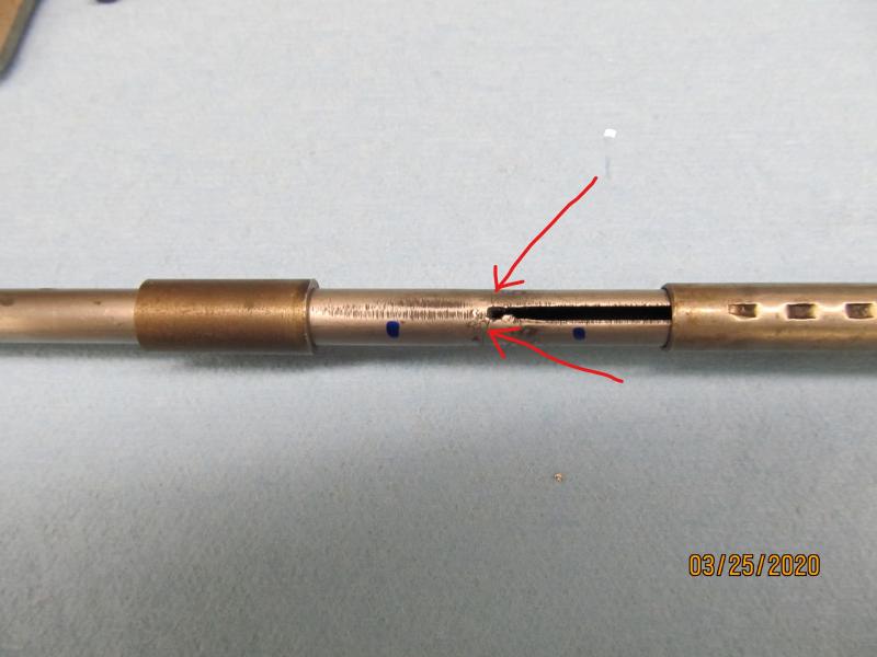

BTW, if you do find a problem with the stator tube slot, consider repairing rather than replacing - I found last spring that the replacements can be 'marginal'. Tom Monaco at Tom's Import Toys suggested I epoxy a sleeve on mine. I'm not confident of epoxies so I brazed mine on but either way I ended up with a better part than the replacement I bought from England.
Picture of the cracks forming on mine with red arrows (had been welded 20 years ago but was cracking again). So I brazed the sleeve on but then, since I had some parts coming from England and could in effect get free freight, I decided to buy a replacement and below you can see the quality of what I got....

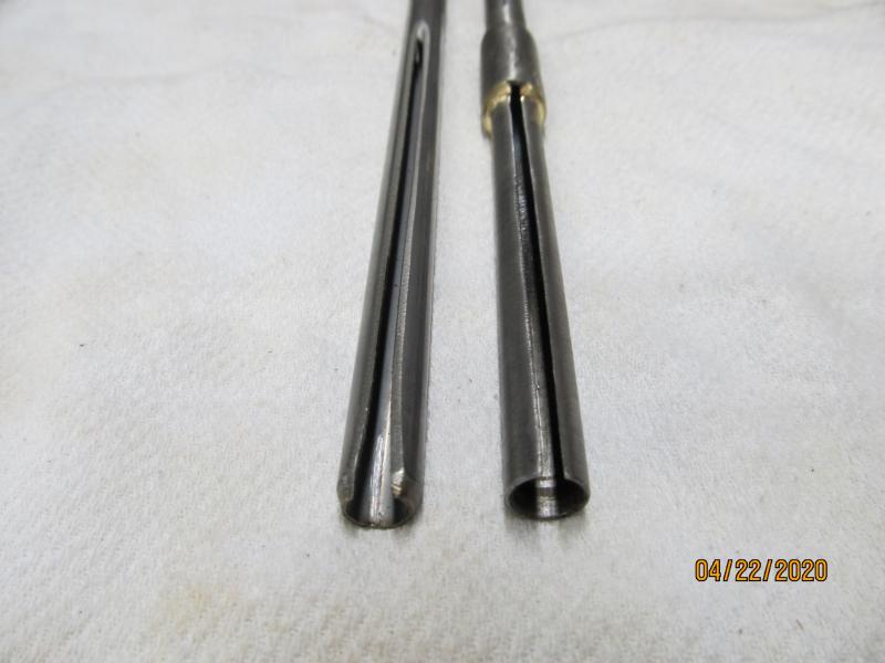

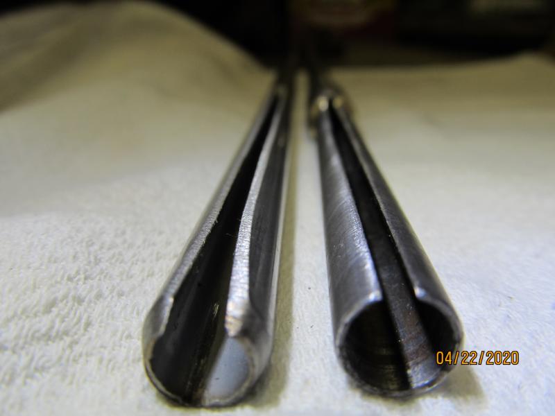

Pics of my repaired one next to the new one from England. As you know, the width of the slot is what controls the rotational play/slop in the trafficator and it's obvious the difference - the replacement looks like it was done by some guy they drug in off the street and handed a grinder to.... OK, QA/QC rant over :).

I bought a Moss stator tube (from Tom, IIRC) a few years ago and the slot was identical to the original. I discovered the old stator tube is an excellent source of 5/16 ID x 3/8 OD bushing stock.
