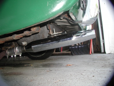

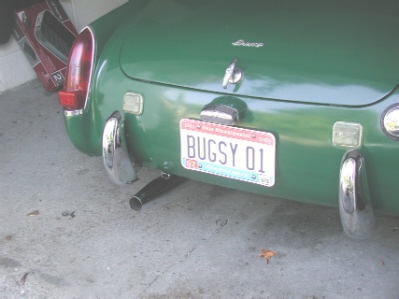

This is what I did with Bugsy my '68 Sprite. And it sounds GOOD!!!!! The cost, free from the Harley Store junk heap. This is the time of year to go asking about those throwaways. A coupe of adapters to get it to 1 1/2" and you are good.

And another. Not sure what type of bike this was on originally but this shape is good, get the bullet shaped narrow down tip. The ones that go into a very large slant cut tip makes the car sound like a rice rocket making loud farting noises. This is the shape you want.
