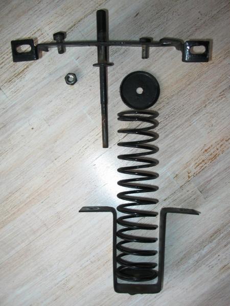

I took the plunger along the edge of the front apron (valance) apart and had a machine shop turn down the shaft that extends upwards. Then he turned a piece of black Nylatron to put the OD of the shaft back to the original diameter. I had him turn a top-hat type bushing (also out of Nylatron) and the noise has completely gone. I think that the original painted vertical shaft wear on the OD just a bit in the hole in the sheetmetal top of this assembly - even to the point it may become oval and this looseness causes a noise.
But the engine is tuned properly where it idles at 400 to 700 RPM and, as we say up here "Voila".
