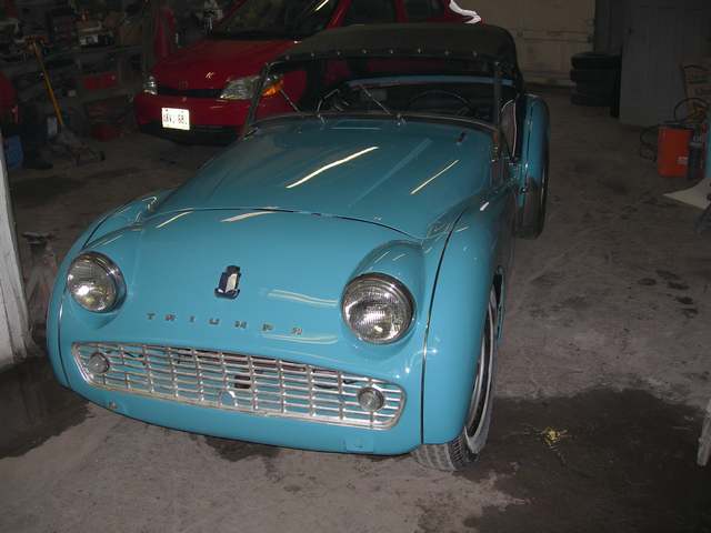

I sold the blue one to a guy in Hamilton in the the end, he was quite pleased with it and it was the right decision for us at the time...(impressed you found the photo)
Plan on going slow and steady with this one (which is really not in my nature) - but my eldest (11 years) has taken an interest so the resto should be fun. Today i will put the car up on jacks to see what the underside really looks like.
Although the lower fenders seem pretty solid, better than the blue car was, the upper parts seem to have a bit of bondo and cracking (can just see in the nearside of the shot above - thanks Scott)
