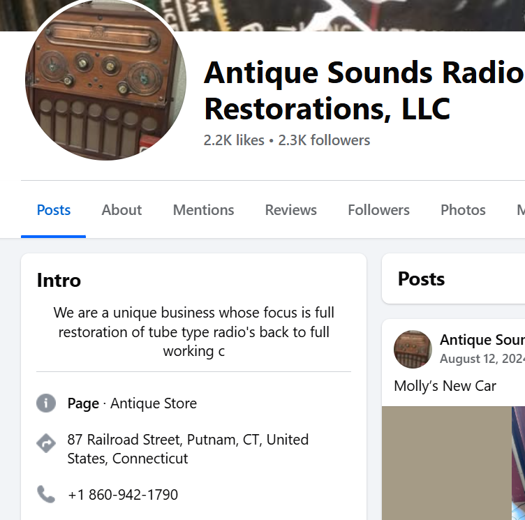

Is there a ham radio/ radio restoration club or place in your area? even someone who restores older cars?
EDit:
Thanks JP. I'm familiar with the place in Putnam - they take the radios, charge 50% up front - then after months of delay "waiting for parts", the radios disappear from the shop.
The one in Pomfret closed several years ago.
