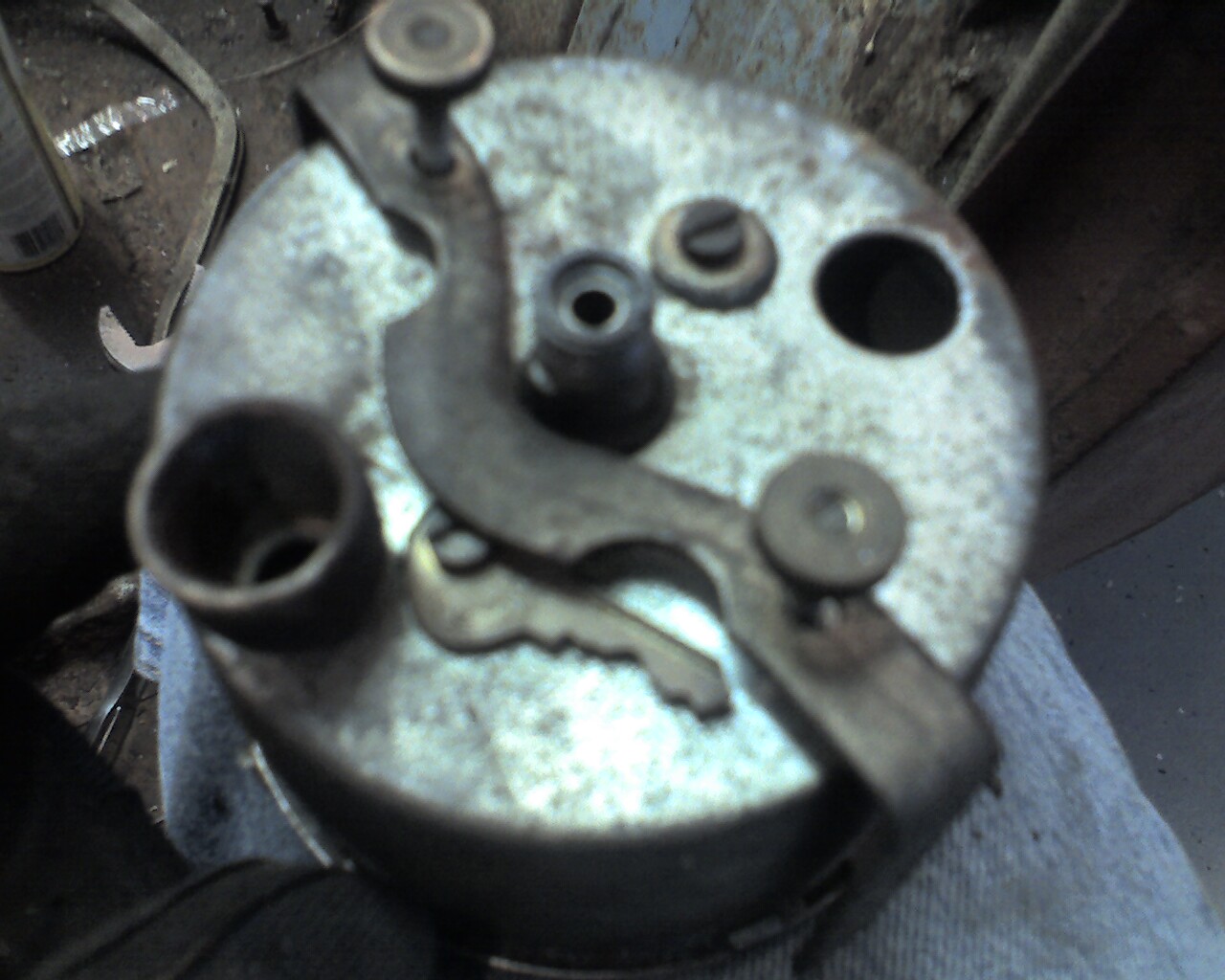

I'm cleaning the years of gunk off my 3rd member or chunk or gear set or whatever you call it before dropping it in my parts washer to clean in ptreparation for rebuilding it.....as you all know, the 'chunk' was never painted (differential or rear end or axle case was painted black before the gears were bolted onto it)....well, right there, on the top rib of the case is a painted green square!!
...& its also on the inside of the driveshaft U-joint to differential flange!
Wonder how many places on a Midget we can find that green inventory (or whatever) mark?

Wish my PO had not painted the back of my dash...wonder which of those crayon marks are relevant to all cars & which are specific to yours?
