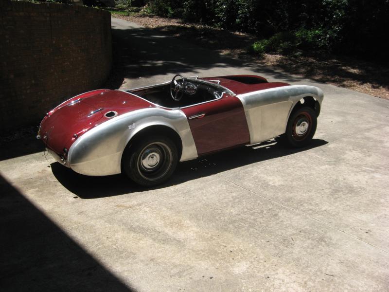

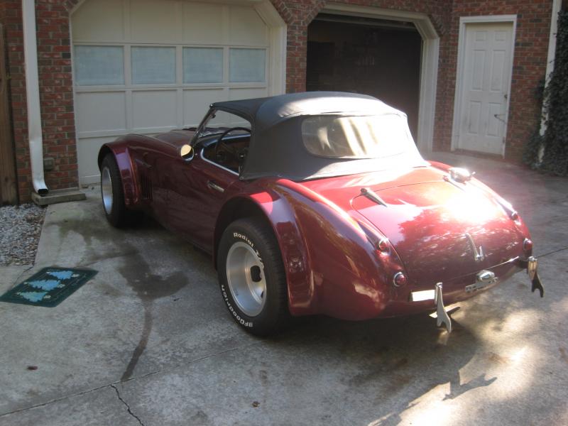

i recently bought a set of aluminum fenders for my v8 converted 59 bn6. when i bought the car it had huge flares and huge tires and wheels. i knew that i would replace those as well as the fenders but had no idea that body parts could be so difficult to fit....properly. i found a set of aluminum fenders with moss part numbers still attached that had never been mounted...at a very good price! i can do most things mechanically but after trial fitting of the fenders i am very skeptical of my ability to mount properly...so i am off to a local very well respected body man to have him take a look and advise me of the issues that will have to be overcome for a nice car....wish me luck and if you are considering replacement fenders my advice would be to try to find original ones.

... my advice would be to try to find original ones.
Which aren't guaranteed to fit without tweaking, either. Legend has it when assembled the body assemblers would try different pieces from a pile--and picked the ones that fit together best--and they still usually required some, uh, adjustment. I acquired some used OEM rear wings for our BN2, whose wings were rusted out in the usual place (bottom of the 'dogleg' portion). These required quite a bit of sworking to fit halfway decent.

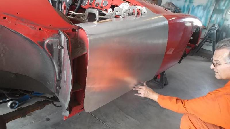

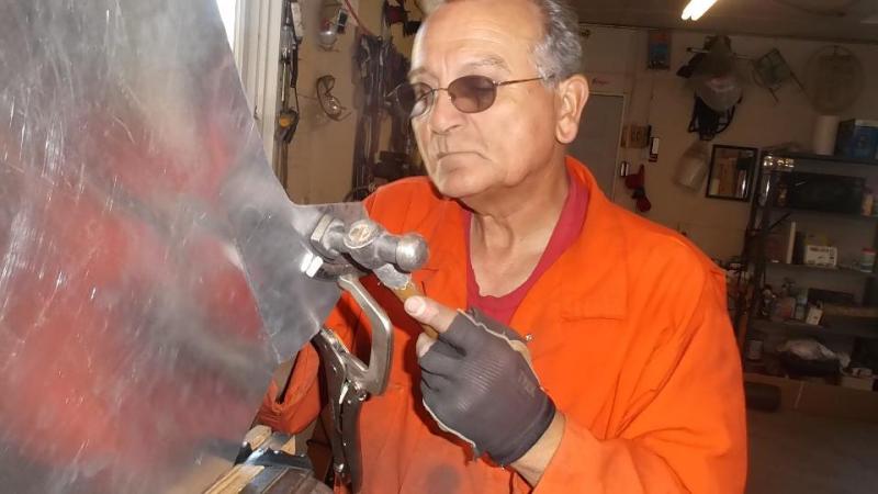

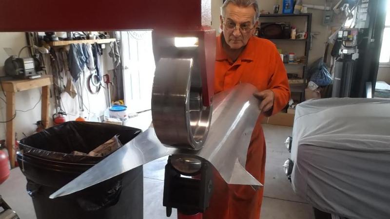

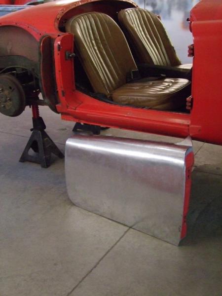

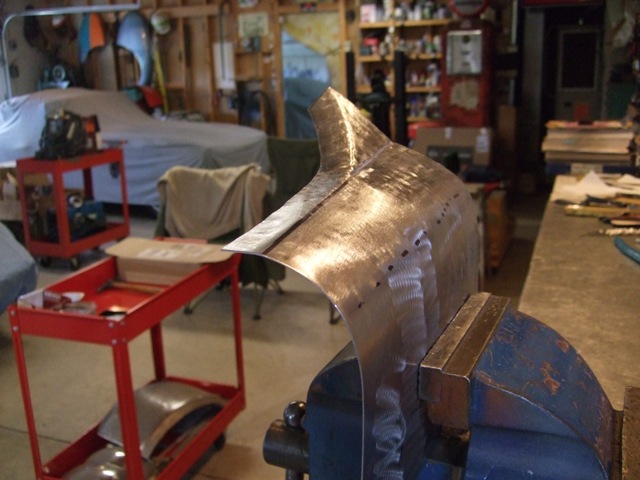

Max, contrary to popular opinion aluminum is not any harder to make fit than steel. It is just that you have to take your time, be careful with it and if you must weld then you will have to tig weld it which most shops don't do. If you find a skilled metal man and he is willing to take his time the aluminum can be fitted quite easily. I will guess that most shops will want to charge a premium to do alum because it is not their standard practice, but if they are willing I'm sure they can get it done.

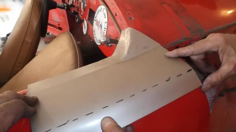

As an example, I have been shaping metal (panelbeating) for quite a while now but I have never had the opportunity to work in aluminum. Well about a month ago I did get the opportunity. I created a new aluminum door skin for an MGA roadster. I found that I love it. The aluminum is so much easier to work with. Not near the hammer work necessary with steel. Easier to shrink and stretch. You just have to be careful that you don't over work it. But all materials have their limit. Here's some examples. Hope you find the right guy. Also, I have to say, unless I was racing and looking for all the weight reduction I could get, I would not put aluminum on my car. The heavier car with steel rides better and the steel doesn't dent and mark up like aluminum.

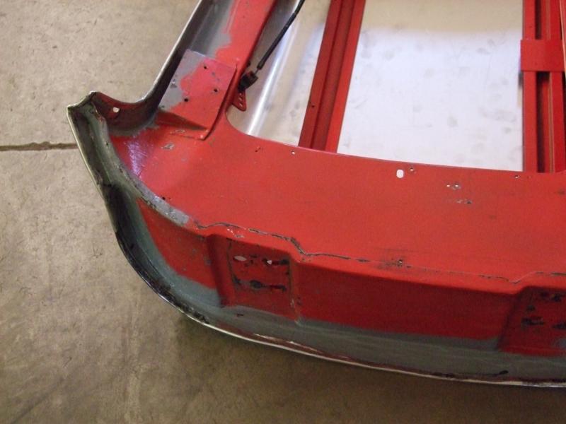

i decided to hold off on the body man visit and spend a day with the panels on the drivers side which did not line up as well as i would like. after a few hours of trimming and enlarging body mounting holes i have the drivers side in good shape. lower front shoud area will need some work to match up the fender lines below the headlight and turn signal opening. it appears that the fenders have the larger bump for the later turn signals. but, that can be dealt with easy enough. this car is not a restoaration but i still want it nice and clean in appearance. thanks to each for your comments....and yes i would have preferred steel for maintance sake over aluminum! my user name is maxwedge....from the old muscle car days of the of mopar maxwedge cars....some had aluminum front end body parts and lots of elbow ripples from lookers leaning in!

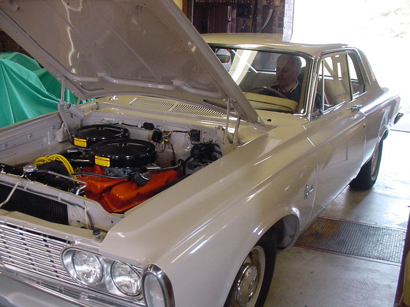

Maxwedge, I have always wondered what one of those intake manifolds, all up with the carbs and air cleaners weighed. I hope that Chrysler cast them from aluminum (but it wouldn't surprise me if were cast iron!). That's a nice old Plymouth ('62?). I'll bet it moves! Jim
maxwedge5281
maxwedge5281
aluminum i think and had been reworked for better horsepower. it is a 63 plymouth savoy and in drag racing form was a 10.2 seconds car in the 128-130 mph quarter mile. i bought it with a broken engine. it had been rotissiere restored and raced on the nostalgic super stock circuit for a couple of seasons back in the early nineties. it had been decalled and painted to match arlen vankes ole brownie drag racer from back in the day! i sold it a few years ago to a friend.... it was a super nice car and like new!!!! it was not an original maxwedge but rather a very well done copy and with a 528 cubic inch stage three maxwedge engine!

rick, the guy i bought the fenders from also had the louvred hood, door skins, and the trunk lid in aluminum. but, the fenders were what i needed...i looked for steel but could not find and got the aluminum ones at less than half moss pricing....and they have moss stickers on them! i do wish that the front fenders had the rally vents, but nope! i got the drivers side on and lined up fairly well. my intent is to mount the fenders with lights etc and drive for a while as it is..partial body paint and unpainted aluminum. then maybe this winter i will have it painted! i still have ny bj7 nasty to drive in the meantime!!!
