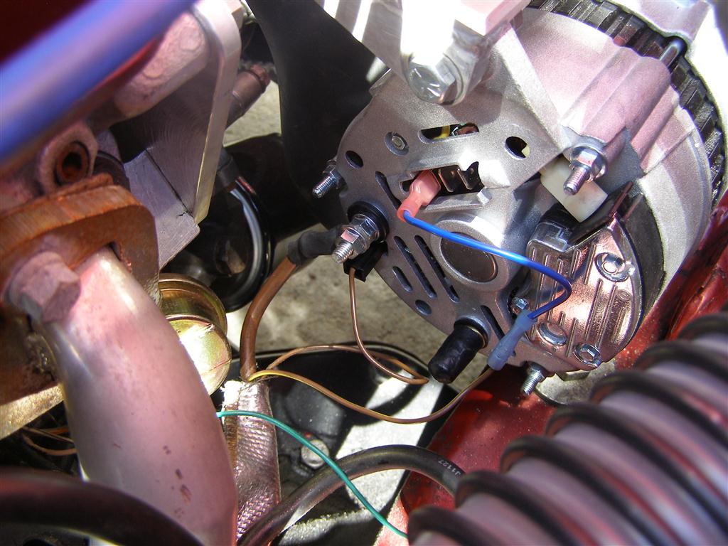

It's been on my TR6 for about seven months and on my TR8 for about three months. They make them for all years.
First the TR6: Brosky 95 Amp Alternator

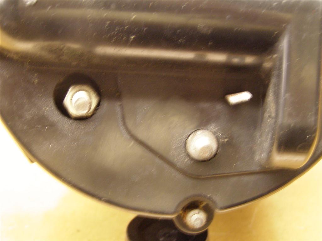

And the TR8, which is a bolt on swap too. Just use different terminals for the wires. And also the back of the stock TR8 alternator.

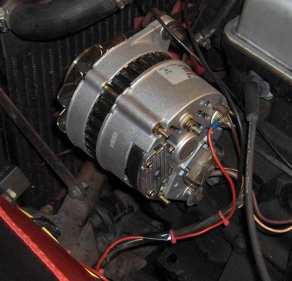

I can't compete with Paul's documentation process, but that alternator looks just like the one I installed in 2008. (The wiring connector clip looks like it should be there.) I got mine from a shop in Austin Tx, it was mailed to me with a working pulley on it (though not chrome). Don't remember what I paid, NFI etc, but PM me if you want the shop number.
However, mine is ONLY a 70amp version. I've had no troubles, it bolted right in, though I did need to get a slightly longer belt. I immediately noticed an improvement -even at idle, the lights are bright. I put about 15k miles on it since installed, and have only the extra loading of a thermostatically controlled electric radiator cooling fan and stereo -someday the A/C will work.
Leece Neville part number 66021636c (AS123 Alternator) 12v 70amp.

And Don, I did run a new 4 gauge wire from the alternator to the starter on the TR8. I will do the same when it warms up and I install the gear reduction starter in the TR6.
