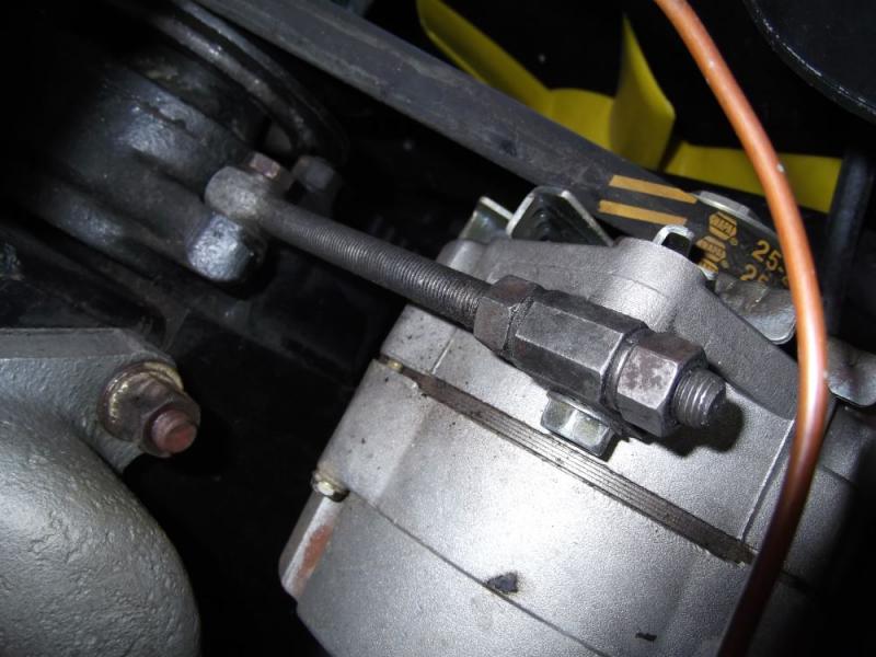

I have a BW alternator on my TR3a and have no whining. Make sure the alternator is aligned with the water pump and crank pulley. Then make sure you don't have the belt adjusted so tight that you put side stress on the bearings. It's hard to get it adjusted right when there is so little play between too much and not enough. I ended up putting a turnbuckle type adjustment rod on my car to be able to dial in a good feel for the tension.
Once you are satisfied that the installation is correct, then talk to the folks at BW.
Not sure what you mean by "turnbuckle type adjustment"?

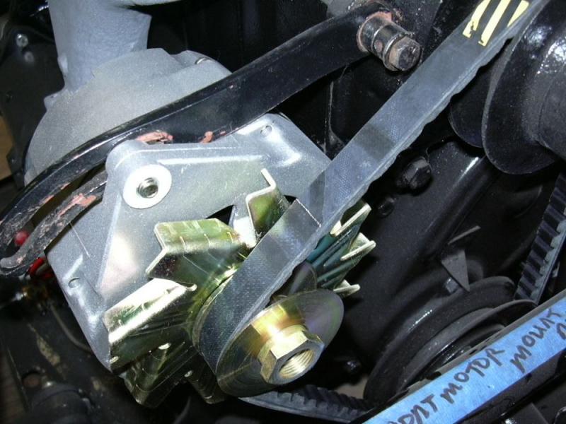

The first photo shows the alternator adjusted out as far as I could get it with the belt attached. Second photo shows the amount of adjustment available between full in and full out .... had a hard time getting the proper tension on the belt and then tightening the bolt without moving the alternator. Third photo shows the turnbuckle adjuster rod I used (I think it came from a Jaguar); adjust till you get the proper tension, then snug up the lock nuts on either side.

Thanks for the pics Joe. Is the collar of the turnbuckle adjuster on the engine side attached to the water pump? Is that a TR6 fan I see? I have one on my car but had to mount it reversed to get clearance.
