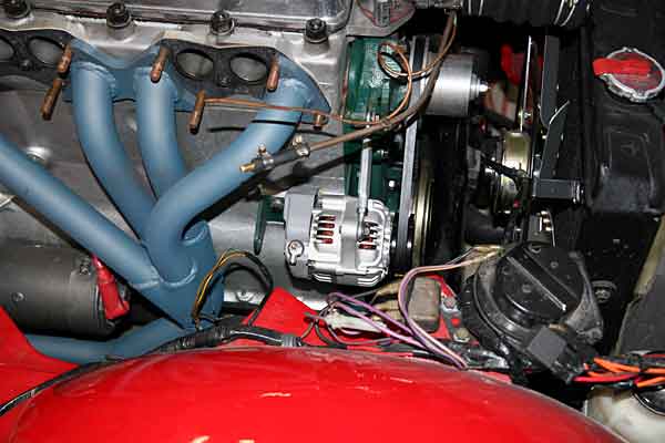

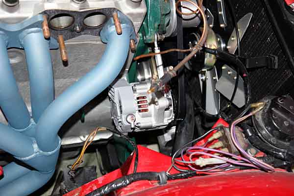

I took some pictures of the Nippondenso alternator in place. The only mod I had to do was to shorted the mouting pedestal by about 1/2", then I drilled out and retapped the hole for a 3/8" bolt.

I like your adjuster. What are those called again? I want to use that on my 6
Turnbuckle. I added some jam nuts as well, one is left-hand thread.
The stock bracket would have worked, but it looks kind of cool.
