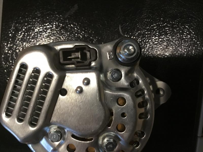

Ok alternator showed up today.
packaged better than some wine I have ordered
weighs in at about 5lbs
nice finish on the case looks good
in the box is the test sheet sort of like a grocery recept with perforated side holes tractor feed printer
it has the actual test rpm =amps results and a graph of the run.
i have never bought an alternator that has come with this info sheet before
14.29 volts 54 amps peek @ 5,000 rpm
14.25 volts 14 amps @ 1500 rpm
regulator turn on 1230 rpm
regulator active 523
max watts 712

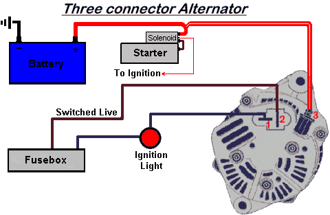

Wiring for my new alternator to idiot light
Looks easy enough I'll let you know the cut in and out voltage in run and if it lights up brite as expected with the ingnition on not running.
the cut in - out rpm is 523 but crank pulley is way bigger so not sure if I can coex to run at a low enough speed to cut out the charge point
may just loosen slip the belt?
wait and see.

Curious to see if this works. That is the diagram I was looking for. What is the part # for this alternator from this site?
Jim_Gruber
Thanks for the update. I see how the circuit works I do believe. Idiot light can get power from battery if alternator cross out or belt bread. Don't you need a diode in the to prevent Voltage going back to alternator from fuseblock ? Just let me know if it works . Thanks .

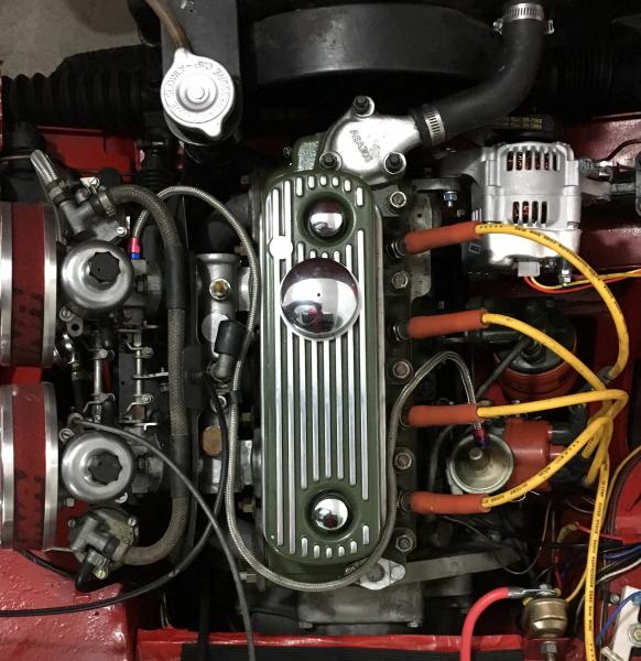

So all done .
took it for a spin bit nippy out but dry and no snow or ice!
a rare ocasion here this time of year.
So it charges,ing. light comes on, can't call it GEN anymore
and goes out.
and does look like an after market turbo strap to the eng. like the delco remy 70 's alternation did.
had to a little milling on th emoting flange to get the pulleys center to center correct but not a huge deal.

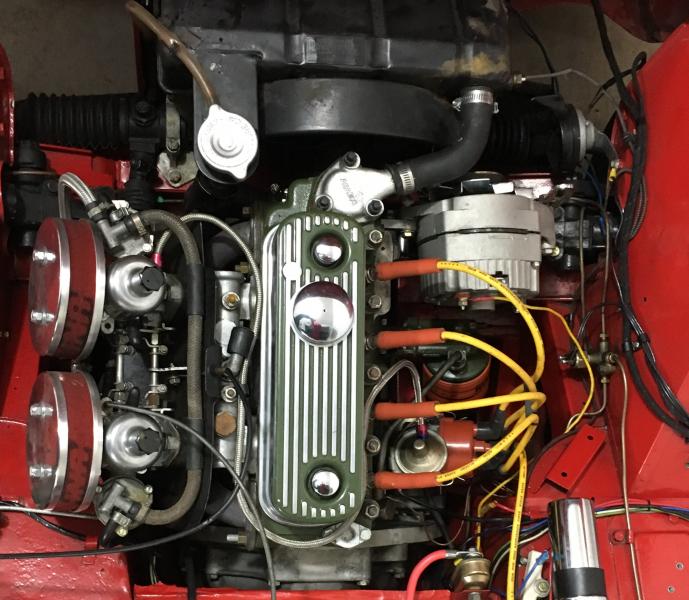

before picture

After picture
whew like it much better.
why did I not do this years ago..
