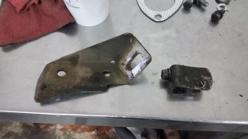

So, except for painting the wheels -- it's done. Great oil pressure, coolant staying where it should, engine is smooth as sick and surprisingly quite. Everything is attached as it should be ----- BUUUUT .. I have a couple of stragglers. Who knows what these are and where they go?

For every project of "N" parts, there is always N+1 (or N-1 available). :wink-new:
B
Bob Buxbaum
True. However,after working on 3 Series BMWs (84-05), I have NEVER had "leftovers". The item on the left MIGHT be something to hand the exhaust from at the bellhousing. I remember the other, but not where it goes.
