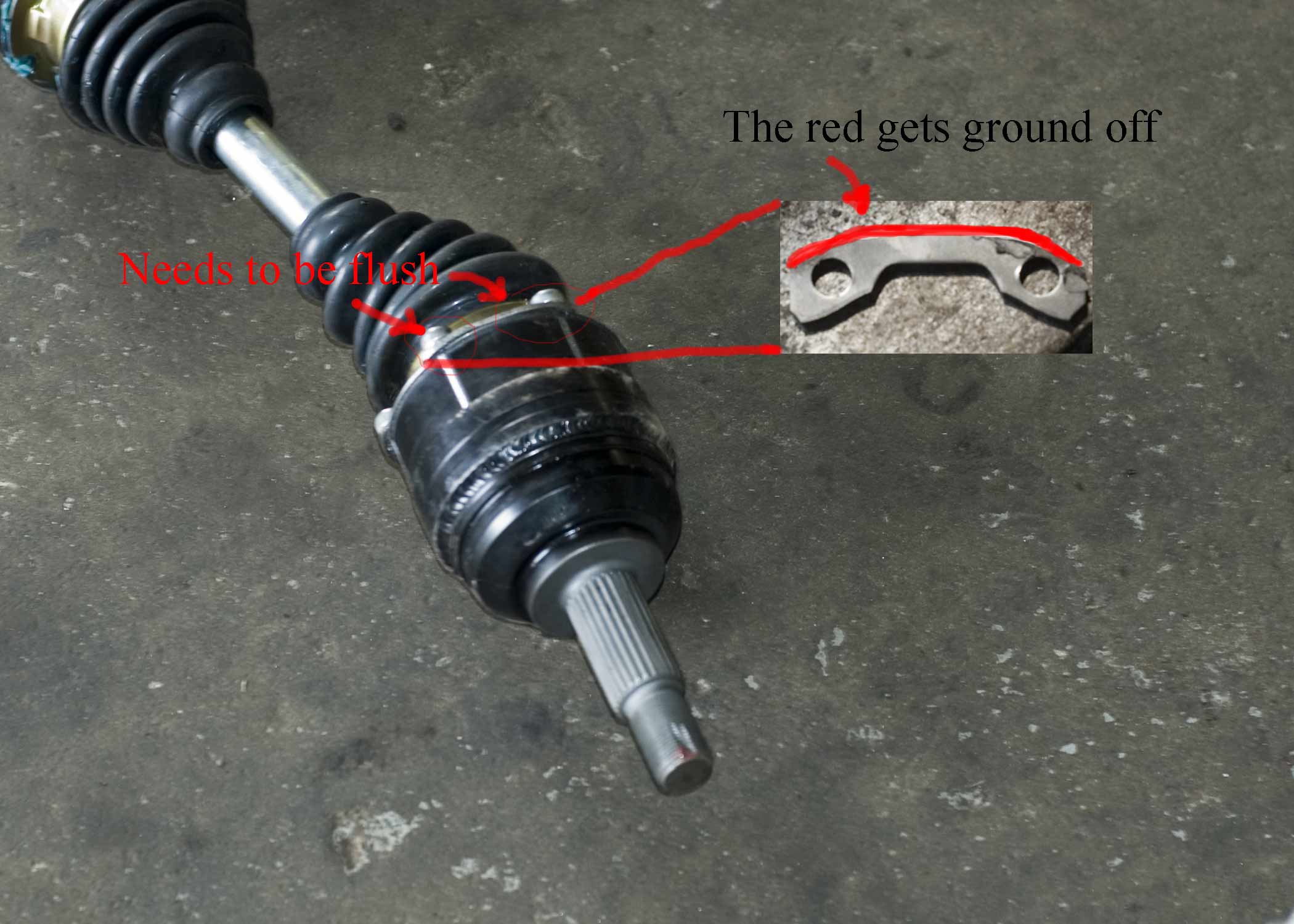

2. The guy provided these hand-made thrust washers to spread the load on the CV joints. They were made in a hurry and it shows - they are a tiny bit too big (erring on the safe side I guess), and they hit in a couple of spots where there is casting slag on the inside of the swingarm while we were testing for range of motion.
He's already said he'll make better ones for the next set - he also offered to send me some when he does, but no way am I taking the assembly off to install them once its all in. I'm going to grind the ones he sent down to be flush with the cv assembly - 5 mins on a bench grinder and they'll be perfect. I'll try to find a pic so you see what I mean, but its on a different computer so you might have to wait a few hours 'till I get to it.

Here ya go - you'll see just how trivial it is from this picture...

Alan, that is a good picture it looks good. Hopefully that guy understands that we want to see it work before we buy, Im sure there will be alot of us. thanks
