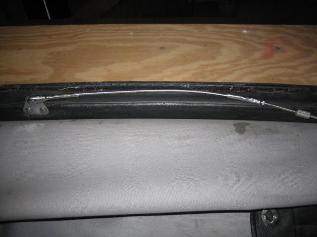

Basically it consists of making a stay, one end of which attaches to the top using the (existing) center triangular chrome "header rail retainer" and the other end of which passes down through the scuttle and allows you to tighten the hood down via a wingnut or knurled nut from behind the dashboard.

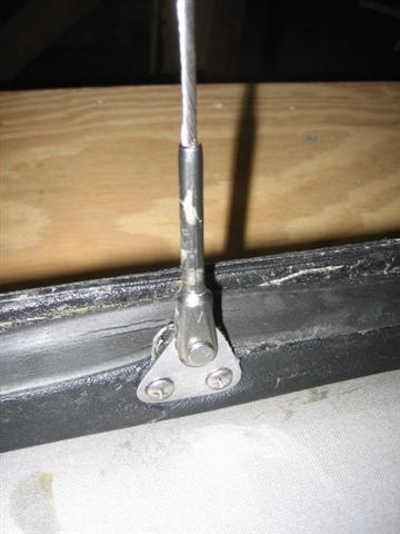

1. Attach fork to the retainer using the clevis pin.

Here's a closer shot of the fork end attached to the retainer on the hood.

Here's a different view of the whole device "erect". You can see that the stay pivots on the triangular "retainer" so when the hood is stowed it folds away easily and does not have to be detached.
