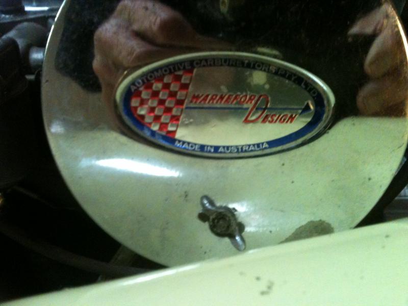

The foam of my air filter has disintegrated ( after years of storage). The case says Warnefor(d?), Marketed now by Uniflow but local supplier cannot find it. Anyone got a part number? or other suggestions? Budget is an issue! Parts are not necessarily the same north of the border!

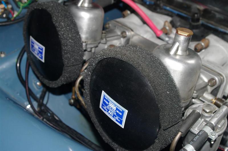

Not sure what sort of filter you have. The stock filters have no foam though I made some Koozies for mine to keep out desert dust:
I used ShopVac foam on the TR4 but needed a bigger I.D. for the TR3 version.
Photo is of the outside of the filter, and my hands. Inside seems to have been foam trapped between two corrugated rings that are still intact. Are you suggesting ( as in an old thread you and others have) that I cut out foam from a shop vac filter and simply replace what i think was there? simple, elegant and cheap.
I have no idea about the physics or mechanics of these things! I started off with a car that had an oil bath, graduated to corrugated paper (a large thing on my wife's BMW 2002), and now I seem to have come to almost nothing except a piece of fluff that falls apart over time!

I don't know the mechanics of them either - but when I added the foam Koozies shown above they did not change the idle so I concluded air flow was adequate and it seemed that filtration had to be better than just the original wire mesh.
On yours you might note the idle speed without them then again after you have tried a replacement foam element.
From my experience, a better test would be under load and full throttle. At normal road speeds, a slight or even moderate restriction in air flow would not be noticed.
Tom
I did use a Shopvac filter to make some foam covers for my original air filters. Foam filters were made from Shopvac filters 905-85 cut to fit width of filter body. You get two carb add-on filters from one vacuum filter. I was not the one to suggest this approach (sorry, don't recall who first posted this information). They have been installed for about 4 years now and seem to work OK. Not really sure how effective they are, but got to a bit better than the "rock catcher" originals alone. I also had some aftermarket filters that I originally planned to use but never came up with a replacement filter material or suitable paper element. Cheers, Mike
