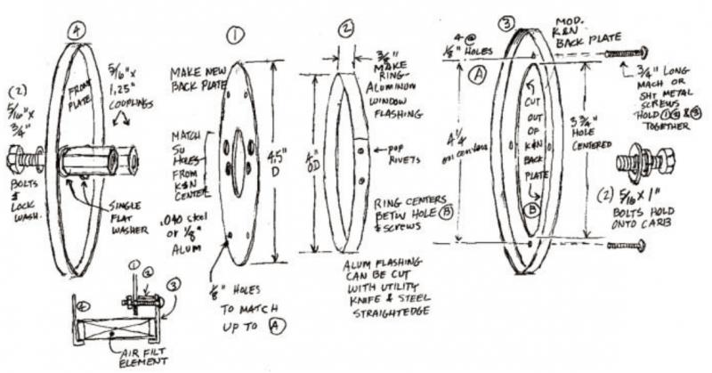

I also have a MKI BT7 that I'm restoring. I like the K&N's. Think they do the best job as far as filtering plus they look good. Not for a concours restoration, but are far superior to originals. Think there's a term used for the originals, something like gravel guards. Think Moss and VB carry both styles (K&N and original style), plus the pancake style.
The cone-shaped K&Ns have the easiest clearance in the front. The 1-3/4" thick cylindrical K&N is a tight fit between the front carb and shroud - possibly causing bending of the shroud edge.
The front one can be relieved to give enough clearance. See: https://www.healey6.com/Technical/KNFilterMods4.pdf
