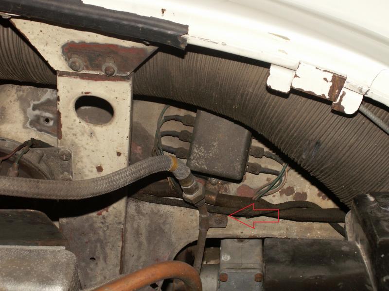

I am searching for the wheel arch spacer (AHH5297) or the dimensions. I have tried the usual suppliers without any luck. I am currently restoring a BJ7 and I have found this forum an invaluable resource.

It is the spacer which goies behind the fuel line clip on the lhs of the front inner guard. From all the diagrams I have seen it would be simple to make but just need the dimensions. I have attached a pic showing the clip.

vette
Sorry Greg, I don't remember the spacer, but since I'm not a concours guy I probably wouldn't worry about it anyway. If you are trying to achieve absolute original restoration I can under stand your concern. Other than that I would make whatever you want. My line probably isn't even in the exact spot anyway and I just bent it to suit. But if you want to keep looking for it, try Healey Surgeons down in the Maryland/DC Area. They usually keep a good inventory of not often needed stuff. Dave.
Healey Nut
Put a washer behind it and be done with it ........oh wait the concours guys are going to be all over me for such a sacrilegious fix .........

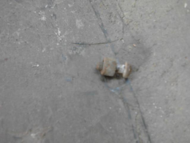

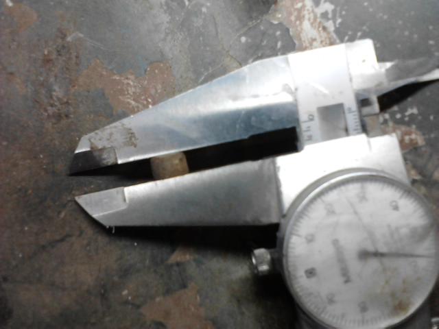

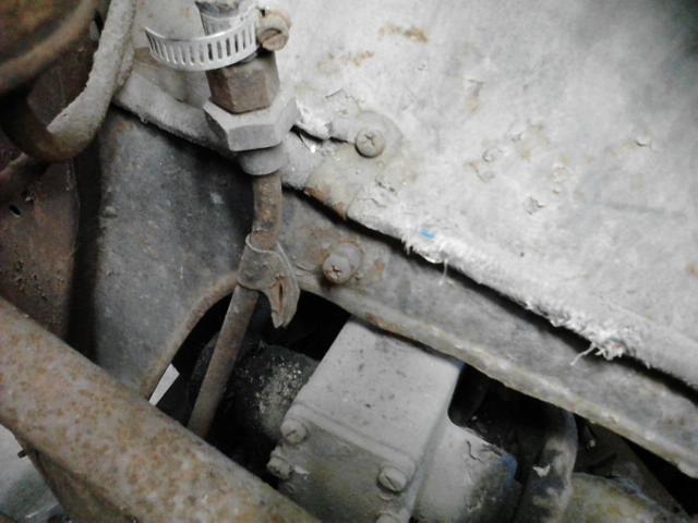

I know this is an older thread and the OP probably made due by now, but I was just moving around my BJ7 today and noticed the spacer in place. This car is non-restored. There is no reason this part would be changed so I am sure this is original to the car. Here are the pics and it measures in at .255 with a slide caliper. So a 1/4 inch spacer would be correct enough.

Any good hardware store has them. I bought mine from a local hardware store and it matched the original. (I did not buy the white nylon one.)
