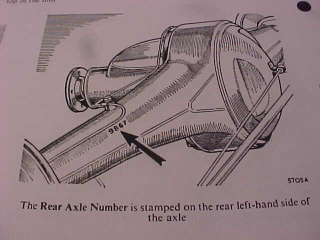

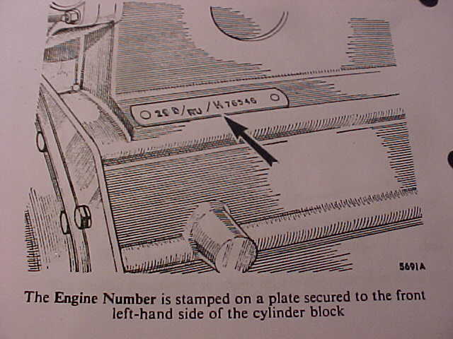

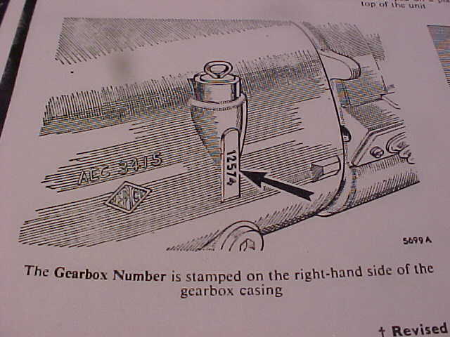

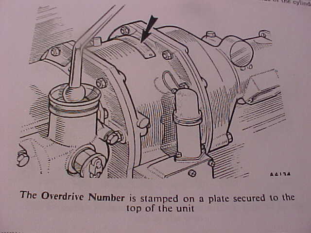

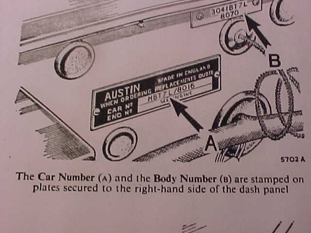

is there another VIN number other than the firewall tag ?
beaulieu, nice find,check the attch. it shows the i.d plate on the center right side of the firewall (as looking from the front of the car with the hood open) as for the snakes,eat them before they eat you, ever have deep fried rattler? very good, and yes you can keep everything you find just not all at the same time!

thanks for the numbers locations...

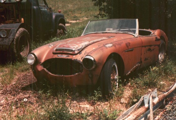

Well, I hope someone from the Forum buys the car. It is restorable, but with a lot of work. First, your going to need some new tires /ubbthreads/images/graemlins/grin.gif Just kidding, I would dissassemble and send off to JULE for a new frame, you're going to need it with that much rust you know the frames ruined. Good luck to some lucky person who has a lot of time on his hands. check out the attached photo of a similar project..
