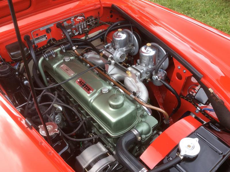

Here is one that I photographed at the recent AH National Rally at Victor Harbor, South Australia. image.jpg

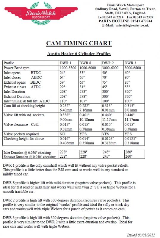

I recently installed a RAWLES manifold and there is a noticeable difference in performance across the rev range but I think
to get the full effect you need the proper camshaft and that might be a good topic for discussion.
I have a Denis Welch DWR 8 cam (rated 3-5,000 for fast street/rally) in my engine and a set of his headers but the engine seems to run out of steam a little before 5,000 rpm.
With a BJ8 cam and the old intake manifold I was able to pull 6,000 rpm if needed without damage to the engine.
For better performance I'm gonna put the OEM BJ8 cam back in which is the cam the factory suggest for racing applications!
I'm still surprised the engine ever ran properly with the OEM intake manifold.
Nothing ventured nothing gained.
Good luck with your project.
Peter

I'm guessing you are referring to the most sporting cam the engine with take without machining to block to clear the lobes. This tends to run less well below 2000 and Rev more than the BJ8 cam, it's definitely faster but it can make for a lumpy tickover.
My guess is that provided the valve time is spot on, you need to get the car on a rolling road and make sure the mixture is correct through the range. They do need different needles.

Thanks for that input Peter. That is helpful. The attachment didn't seem to go.... could you retry putting that in?

Hi Steve, saw this after my recent posts on fuel manifolds. I like the look of this manifold and it is available.
Am I correct that horizontal float bowls are needed on My HD8,s
I will ring SU tomorrow to see if available if required.
