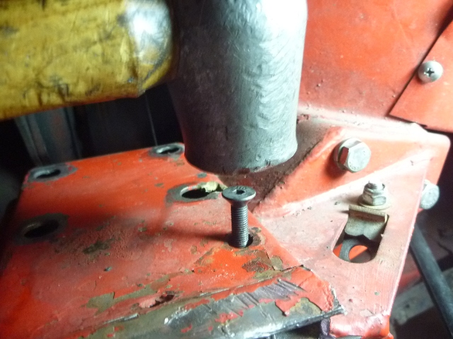

Removal of captive nuts with cold chisel was not going to work for all the nuts. Screwing bolts in and hitting with lead hammer worked easily!
