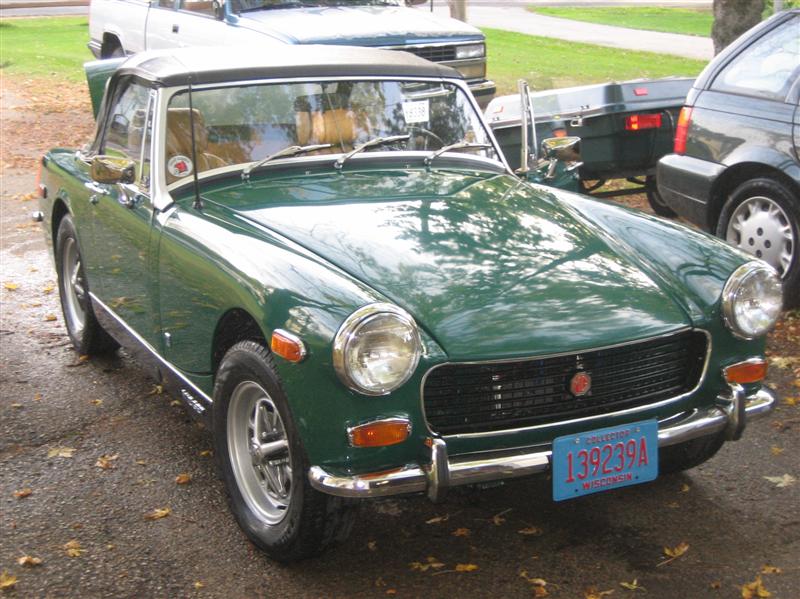

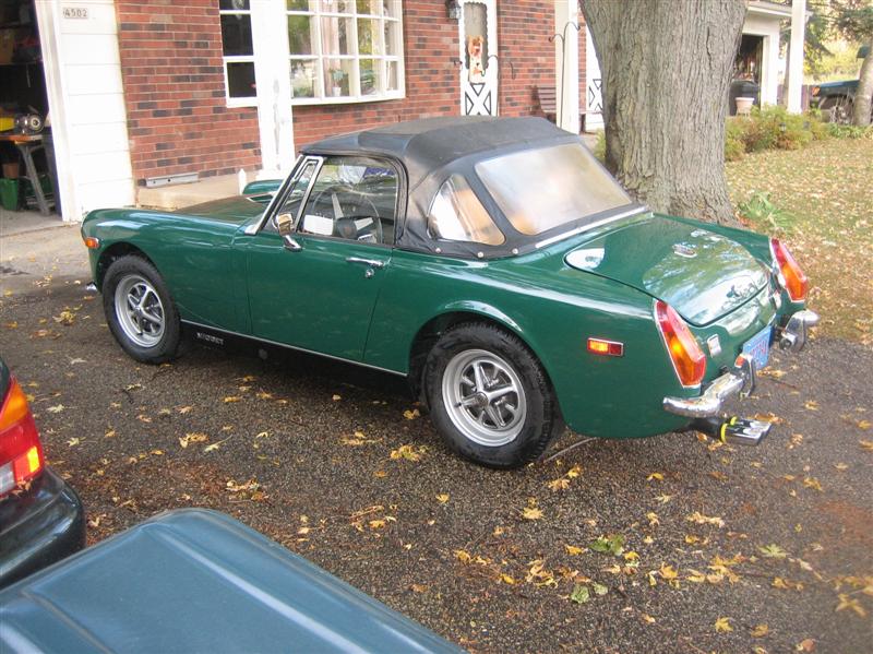

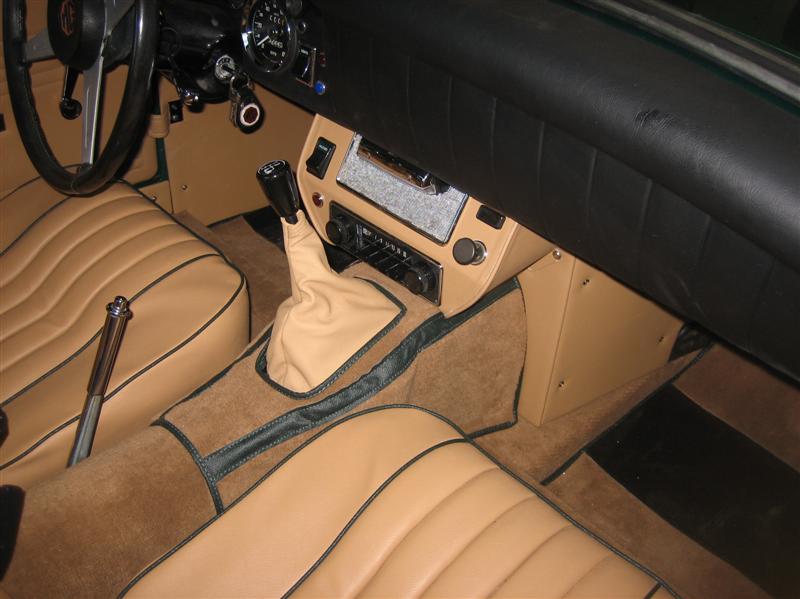

The car was originally orange and had been painted dark green. The paint and body work was pretty bad. The original interior was black. I completely stripped the car and painted it with Eastwood Euro Green urethane. The interior is now beige with the seat covers and carpet by Prestige and the panels by Mirror Trim. Mirror Trim includes some extra material and a couple lengths of matching piping with their panel kits and I used some of that for the radio counsel. The dash has a new full cover and the oil pressure/temp gauge was rebuilt by West Valley Instruments. I still need to install the chrome strips on the grill and replace the rear windows for the top. I hope to have the rear window replaced with a zippered one and to have the pull tabs on the outside so we don't have to reach over and around the seats to operate the zippers.

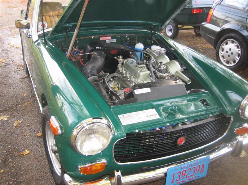

The restoration was complete from the ground up. The engine was rebuilt. Relays were installed for the headlights, horn, and brake light switch. Hela horns were installed because of their increased volume. The SU fuel pump was replaced with a new electronic one and a Facet pump added as a backup with a toggle switch to chose which pump is used. The neutral safety switch, seat belt wires, and door buzzer were all eliminated from the wiring and a new wiring diagram was made to reflect the changes.
