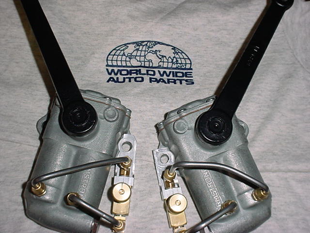

Not to sound commercial, but we are making externally adjustable Armstrong shocks using a similar technique as used by Armstrong on their rear shocks as used in competitions.
Quite a few people are very happy with them. Here is an example of Sprite rears we've done.
Peter C

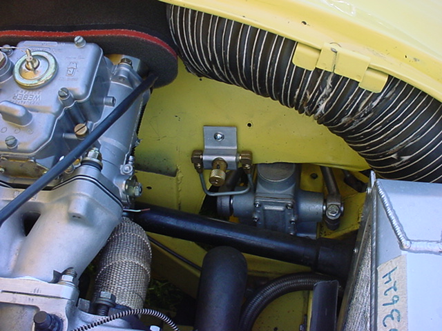

The vintage race ones are installed on MGB bodies to take advantage of the air chamber. Of course that means "relieving" some sheet metal, which most non-racers wont want to do. Here is a pic of that.
It has been a fun project.
Peter
